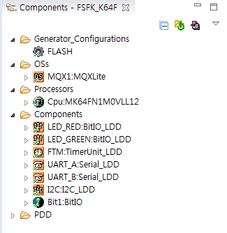

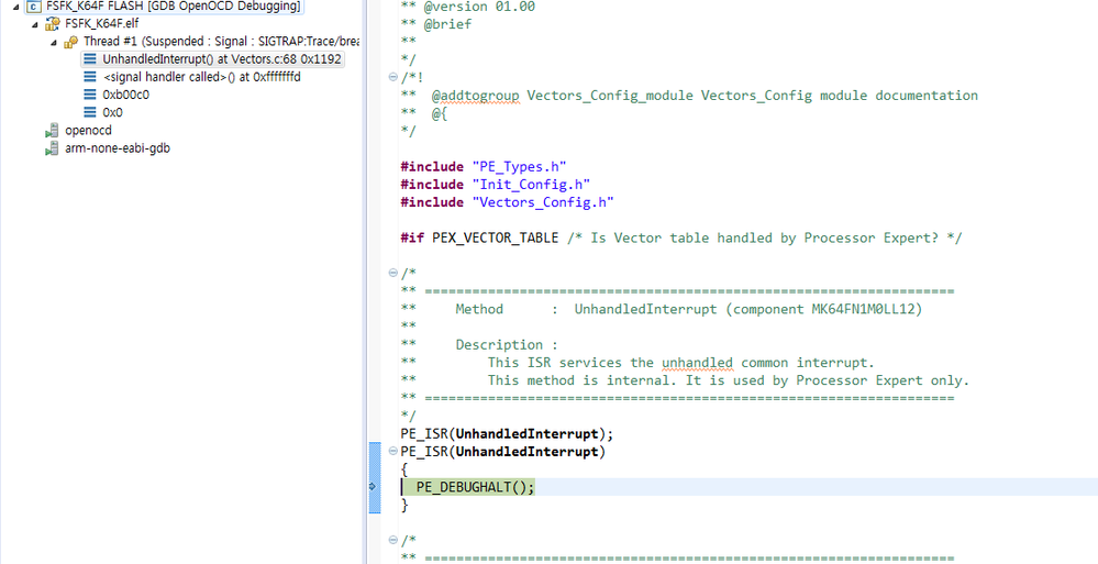

josol
Thank you for kind reply.
I am trying to write or read the data. and i added component successfully
and i found a useful post -> Re: Erasing Flash sectors in KL25 on the Freedom Board.
and i successfully write and read a data at first time. but it didn't work at second time
while debugging, i found that in UnhandledInterrupt, the process stoped.
can i get a answer about this problem? it's my code, and debugging window.
thank you very much

Jorge_Gonzalez
Hello Jo Sol:
I am sorry for the troubles you've had so far. I will explain the issues and attached you can find an example project similar to your code but with corrections.
- First the hardfault you observed was most probably because of over programming the same phrase (8-bytes) without a previous erase. I think this is a bug in the FLASH_LDD component which allows over programming, as discussed in the next thread: What are the rules for random writes to Flash? (K64)
- Luiz is correct about the conditional OR operator (| |).
- The information about the parameters in the _Erase() function is misleading. I noticed that FromAddress must be aligned to the start of a flash sector and Size must be a multiple of the sector size. The K64 has a sector size of 4096 Bytes (4 KB). In your example you need to write to address 0xFFFFA, so you have to erase the last flash sector, from 0xFF000 to 0xFFFFF.
In the example project I enabled Auto initialization from the FLASH_LDD component settings so you don't have to call the _Init() function. Just notice that the first parameter for the APIs would be FLASH1_DeviceData.
I have already reported the issues with the component to the Processor Expert team.

josol
Dear Luiz , Jorge
I tried to erase 0xFF000~0xFFFFF again and now it work well
without your help, i can not figure it out.
Thank you very much , Have a nice day!~!:smileyhappy:
