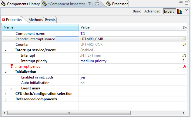

i m trying to write a timers code using interrupts but i m not sure of how to generate a delay of my requirements can only one please help me out on thi

You can use Processor Expert to generate code, it is very simple. In your case, in order to generate an interrupt every X time, you can only add the "TimerInt_LDD" components and set the Interrupt period (see image below); in addition you can set the source and set if you wish the Timer Auto or Manual Initialization.
