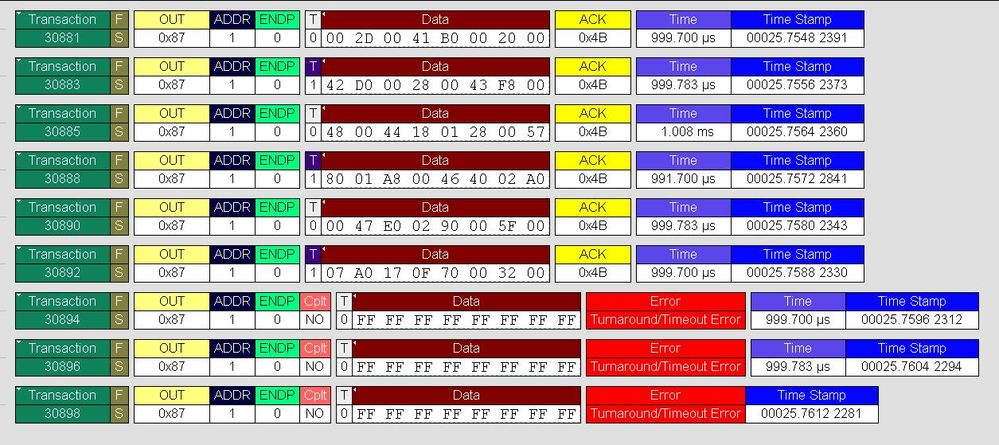

I have problems receiving data at ep0 out. I'm using the TWR-K21D50M board as usb device.
The CDC-example works fine and i managed it to customize it for my needs.
I have a programm which sends data on ep0 out to the device and i can receive it, but if the data is 0xFFFFFFFF or 0xF5F5F5F5, there is a timeout error and i dont get the data.
I dont know why i can't get this data.
The SIE could have problems to receive many "ones" in the data section.
I hope anyone can help me to manage this problem.

Ok, I solved the problem.
There is a problem in the timing for the USB clock. The system clock is used for the USB clock, but the system clock is 50 MHz and USB needs 48 MHz.
So if you change the value of  “PLL0_VDIV” to 24, which is defined in the tower.h file the system clock is 48 MHz and the USB works fine.

I’m not sure if you understand my problem. The communication is alright and I can send and receive messages at EP0 OUT. The only thing is, when the data in the Message, which is send from the PC to the device, includes too many 0xF’s there occur a timeout error. I test the communication on EP1 OUT and there I can send data including many 0xF’s. I think this is a problem of the controller that the SIE cannot work with too many 0xF’s at EP0.
My problem is that I have to use an existing program, which sends data at EP0 OUT.
Here is a screenshot of the usb transfer:
