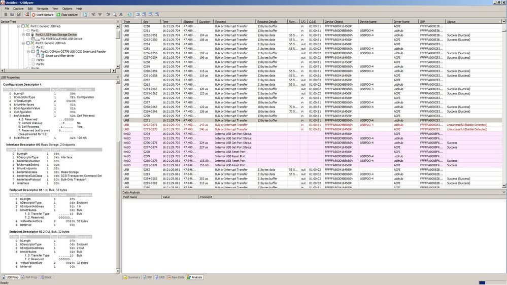

primozrebec
I ran an USB analyzer software on the port where MSD device is connected. When i try to write file to it i get "babble detected" error. Please, see the attached image.usb_analyzer_capture.jpg
