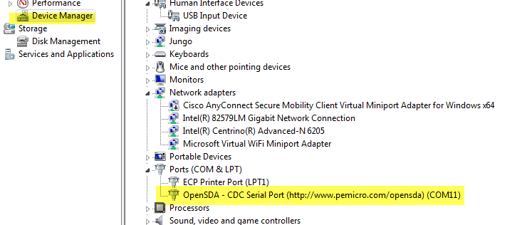

I purchased a FRDM-KEAZ128Q80 from DigiKey. The OpenSDA portion of the board appears to be nonfunctional. The demos work if I connect a 12V source, but connecting a USB cable doesn't power the board or enumerate with a computer. When connected only to USB, I can probe that power is getting to the OpenSDA MCU, but the main power busses are not on. Is my board just defective, or am I missing something obvious?

kerryzhou
Hi Adam,
   Now, please follow my step to test the board again, please use the win7 system to test it at first.
1. Download the according software
  1) Download Pemicro driver and install it from this link:
      http://www.pemicro.com/downloads/download_file.cfm?download_id=53
   2) Download the firmware
http://www.pemicro.com/downloads/download_file.cfm?download_id=378
   Unzip it, find file:MSD-DEBUG-FRDMP-KEAZ128Q80_Pemicro_v118.SDA , this is the opensda firmware, will be used.
2. Change the on board bootloader to opensda
 1) Power off the board, then press the on board reset button, hold on it, plug the USB cable to J7, release the button
   You will find your PC have a device named as "BOOTLOADER"
  2) Send file MSD-DEBUG-FRDMP-KEAZ128Q80_Pemicro_v118.SDA to your "BOOTLOADER",  and wait the sending finished.
  3) Unplug the USB and plug the USB cable again
     You will find your board is a device named as "FRDMPKEA128", just like this picture:
Until now, your on board bootloader is changed to the opensda, you may also find the com port in the device manager:
3. Download the KEA app code to your MSD board.
 FRDMPKEA128 is also a MSD device, you can send the KEA app to this device directly.
Please check my attached Lab1_Blinky_Loop_KEA128.srec, this code will blinking the D11
Unzip my attached code, then send Lab1_Blinky_Loop_KEA128.srec to your FRDMPKEA128 .
The following picture is my test result":
Please follow my above steps try it on your side carefully.
