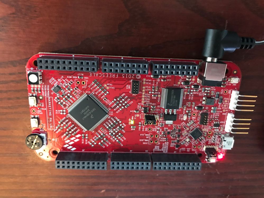

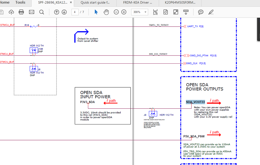

I purchased a FRDM-KEAZ128Q80 from DigiKey. The OpenSDA portion of the board appears to be nonfunctional. The demos work if I connect a 12V source, but connecting a USB cable doesn't power the board or enumerate with a computer. When connected only to USB, I can probe that power is getting to the OpenSDA MCU, but the main power busses are not on. Is my board just defective, or am I missing something obvious?

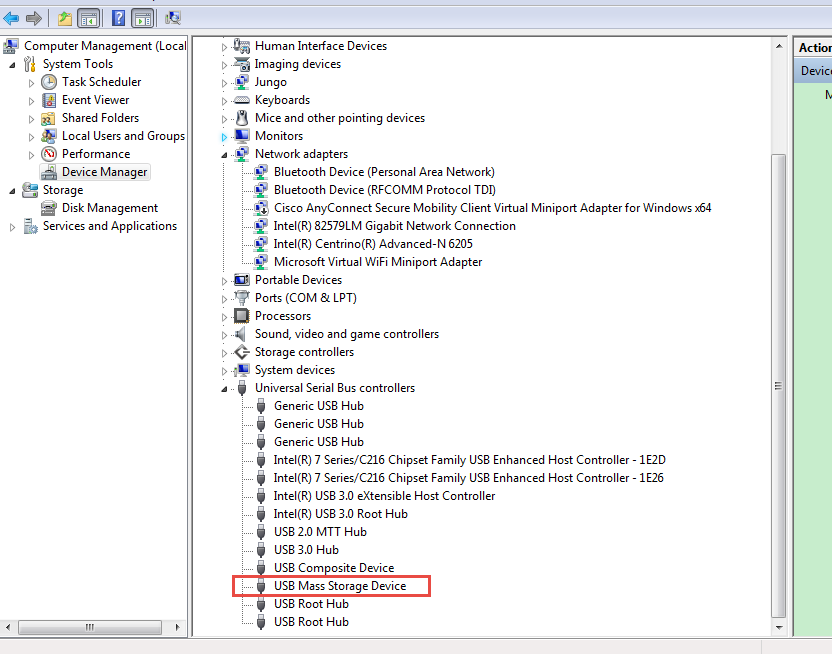

4. After the install is successfully, check the device management, please also give me your device management picture, this is my picture:
Please check it right now.
I have checked again on my side, if the PC driver is not installed for the new board, it will have the same issue as you.
Actually, the K20 work need the PC USB install the driver successfully, otherwise, both K20 and KEA128 won't work in the FRDM-KEA128 board.

OK I'm sorry, I completely overlooked the board that you are using.

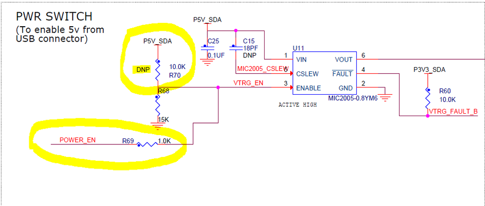

a. In order to enter OpenSDA bootloader mode: unplug the USB cable, hold the reset switch and plug into USB again. If you have the drivers installed, it should show up as a removable storage in file explorer. Open SDA_INFO.HTML to check the status of your bootloader (version etc.). Anyway I think this should work since you say P5V_SDA and P3V3_SDA have power.

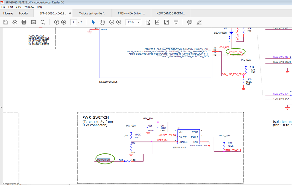

VOUT (pin 6 of MIC2005) is the source of power which the "really important" jumper J107 feeds from.
In order to enable this chip, it either needs POWER_EN (logic signal coming from OpenSDA interface) or R70 to be populated. The default scenario is that R70 is not populated (DNP) and that OpenSDA enables power. That's why I wanted you to try a different bootloader, maybe it was a bad batch they received at Digikey.
So after you double check that J107 connects (2 and 3), please compare your board to the above schematic and report back.

The board doesn't appear at all when I hold down RESET and connect it to the computer. R70 is not populated on my board. Using a DMM I see that U11 has a 5V supply on pin 1, but POWER_EN is driven to 0V.
When I connect a 12V supply and move J107 to connect 1-2, both boards run the demo code. If the jumper is in 2-3, D1 and D3 come on:

I highly suggest you follow my step to change the on board bootloader at first, because I find the POWER_EN is controlled by the MK20DX128VFM5:
So, try to change the bootloader in my last reply, at least it works on my side.

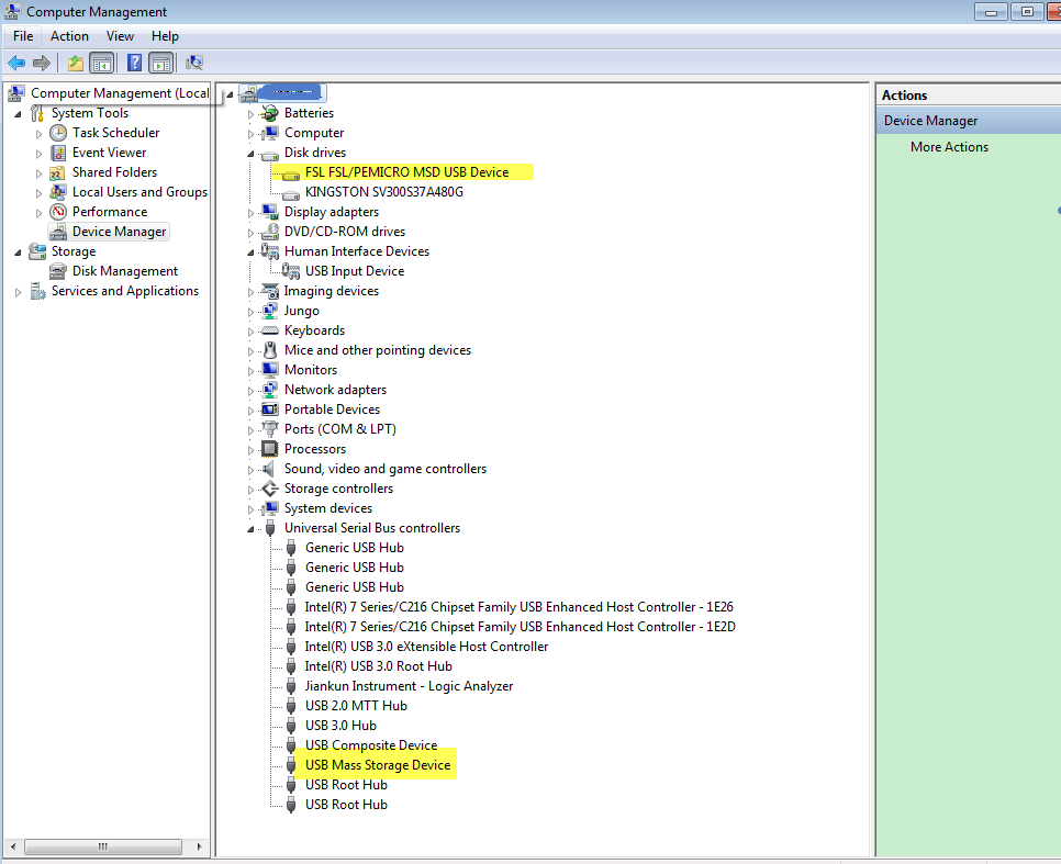

Hi Adam,
    Do you install the P&E driver in win7?
    When you first plug the board, you need to wait a moment, because the PC need to install it, run the driver automatically.
   So when your enter bootloader mode, can you find any USB device is installing?
   Please also check the PC device manager, this is my situation:
  You can also post your according picture.
Kerry

POWER_EN measured at R69 shows 0V.

adamjohnson
Kerry,
It seems it was the driver. I had installed the driver previously, but I didn't restart after installation. This time, I did, and the board finally came up. I've since updated the bootloader on all three boards, and they seem to be working properly. Thanks for your help!
