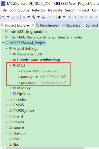

11,035 Views

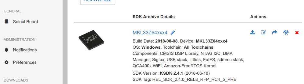

Hui_Ma
Hi Luca,
Sorry for the later reply.
Could you try to builder and download the MCUXpresso SDK software package for MKL33Z64xxx4 chip?
Then you could use MCUXpresso IDE to create a new project and porting [pflash] code to this new project:
Please try if the Flash "erase" command could be executed at your board?
Wish it helps.
Mike
11,035 Views
luca_securo
Hi Mike,
  I did all you suggest to me.
The code who I attached 2 days ago is the pflash code (a little bit adapted to my project).
The erase comand didn't works.
Now I'm working on this way:
#include <cr_section_macros.h>
//execute these functions in RAM
__RAMFUNC(RAM2) void FlashEraseMemory(uint32_t addr);      //RAM2 is the partition made by myself using MCU Settings
__RAMFUNC(RAM2) void FlashWriteMemory(uint32_t addr);
__RAMFUNC(RAM2) void FlashEraseMemory(uint32_t addr){
   __disable_irq();
   result = FLASH_Erase(&s_flashDriver, addr, pflashSectorSize, kFTFx_ApiEraseKey);
   if (kStatus_FTFx_Success != result)
      error_trap();
   // Verify sector if it's been erased.
   result = FLASH_VerifyErase(&s_flashDriver, addr, pflashSectorSize, kFTFx_MarginValueUser);
      error_trap();
   __enable_irq();
   __disable_irq();
      result = FLASH_Program(&s_flashDriver, addr, (uint8_t *)s_buffer, sizeof(s_buffer));
      if (kStatus_FTFx_Success != result){
         error_trap();
      //Verify programming by Program Check command with user margin levels
      result = FLASH_VerifyProgram(&s_flashDriver, addr, sizeof(s_buffer), (const uint8_t *)s_buffer, kFTFx_MarginValueUser,&failAddr, &failDat);
         error_trap();
      // Post-preparation work about flash Cache/Prefetch/Speculation.
      FTFx_CACHE_ClearCachePrefetchSpeculation(&s_cacheDriver, false);
    __enable_irq();
Tell me please if this is the right way.
Thank you for help!
Have a nice day
Luca
