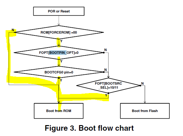

See chapter 23 in the KE1xF user's manual and https://www.nxp.com/docs/en/user-guide/KFLLDRUG.pdf :
regards
Mark

1. Connect BOOTCFG0 to GND
The BOOTCFG0 pin location  is not specified in the KE18's documentation so you may need to ask NXP where it is located.
2. Connect a serial interface to LPUART0 (PTB1 and PTB2) or LPUART 1 (PTC6 and PTC7)
3. Run the KinetisFlashTool on the PC
4. Connect to the board
5. Command an erase
Mark
P.S. It is possible that the boot loader is disabled (in the flash configuration) in which case you may need to get a new board and be very careful to not do the same configuration.

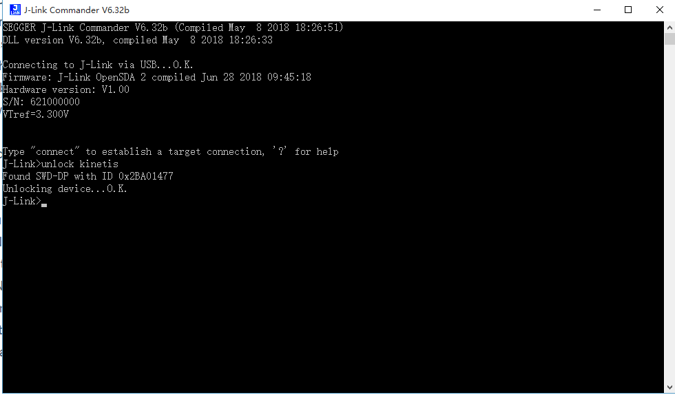

     Here is not a phone number of NXP. So, today, I retry to input the "unlock kinetis" command with the J-LINK commander tool. It seems to be working and it writes that "Found SWD-DP with ID 0x2BA01477        Unlocking device...O.K."
    But when I turn buck to  bootloader mode, it is also cannot dowload program.
   After the command--"unlock kinetis"  works out ,  what should I do.
  Looking for your help.Have a good day.

I don't think that the un-secure command is what you need (this won't necessarily change the loaded code from disabling the pins) - you need the mass erase command to restart with a "fresh" chip.
Mark

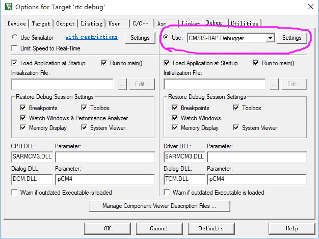

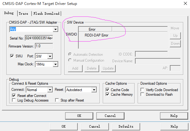

Thanks for your reply. I've tried it under your guidline, but it doesn't work. My board cannot identify the "CMSIS-DAP".
The situation is as follows.
Looking for your futher discussion.Have a good day.
qzy
