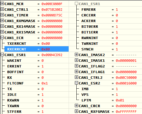

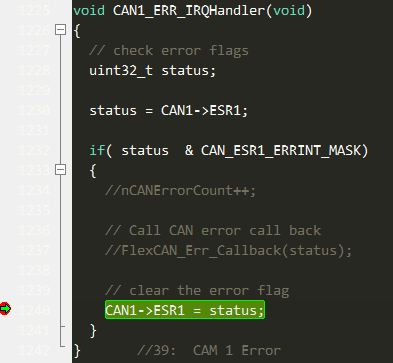

AaronsCook
Hi, Hui_Ma
When I test the CAN in the debug mode, it away report the CAN error which include Bit1 error,Bit0 error,Form error,and Stuffing error.
I open the CAN error, CAN bus off, Tx & Rx Waring interrupt in the CTL1 and Set break-point in the code.
Then I find that when I finish initialize the CAN, it will generate CAN error interrupt.
In addition, I clear the bit in ESR1 in the coed but it always generate CAN error interrupt because it always has Bit1 error,Bit0 error,Form error,and Stuffing error. I feel it can't clear the error, it always be set.
I don't know if these errors has bad effect on the data transfer on the CAN bus?
But now I feel I always lost message when use the MB interrupt-receive mode in these condition.
May be the poll-receive mode is better than interrupt-receive mode?
This the test picture.
Please kindly help me analysis the bug. Thank you very much.
Best Regards
Aaron

Hui_Ma
I think that could caused by the CAN node with different baud rate and bit rate. Customer need to check the baud rate setting and bit timing setting.
Wish it helps.
