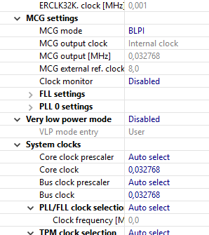

i'm using the KL46 with KDS3.2 and SDK1.3.
I use the rtc to wakeup the micro every 4 minute and 30sec. I use the function RTC_DRV_SetAlarm to set the alarm and i reset the RTC timer to 0, so i have this condition:
  • Actual Time 00.00.00 01/01/1970, Allarm Time 0.4.30 01/01/1970
i read then some sensor and put the micro in VLLS1 with this function:

i read :  Actual Time 00.04.55 01/01/1970 so there are 25 sec of delay ... why this? they are so many...
In clock configuration 2 used in the VLLS1 i have set this clock

There with a similar demo at <FRDM-KL46Z and TWR-KL46Z48M Sample Code Package> ​named [lcd_rtc_lowpower_tower] demo. The default project path is ..\kinetis_kl46_sc\kinetis_kl46_sc_rev2\klxx-sc-baremetal\build\iar\lcd_rtc_lowpower
The demo using RTC as wake up source and will wake up the KL46 from VLLS1 low power mode every 5 seconds.
I checked the KL46 reference manual, below picture shows the MCG module is OFF during VLLSx clock mode.
Customer could not using MCG IRC 32KHz clock as RTC module clock, the RTC module clock source with below option:
Customer need to use TWR-KL46Z48M to do the RTC wake up KL46 MCU from VLLS1 low power mode test, for the TWR-KL46Z48M board provides 32KHz oscillator connects with RTC_CLKIN pin.

yes in fact i use the LPO 1khz like clock source for the RTC. You can see this in the fsl_clock_manager, clock configuration 2.
5,614件の閲覧回数
colin
If you are measuring the extra 23 seconds from real time (instead of from the RTC time on the MCU), it may be that the LPO 1 kHz clock's poor accuracy is to blame.  It is specified as 1 kHz +/- 10%, and 23 seconds in 5 minutes is about 8% error, so it's possible that is part of it.
