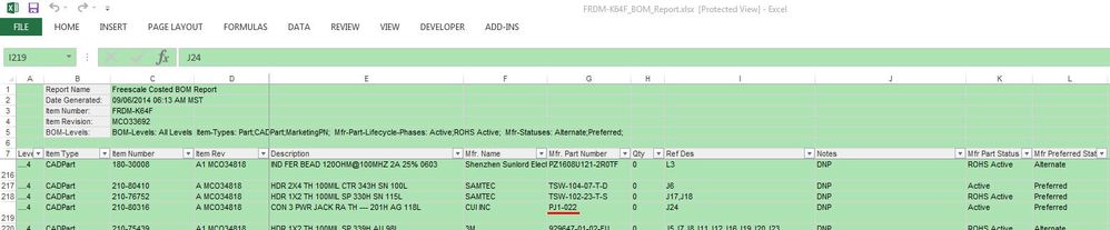

Myself and a couple of people on the Mbed site are trying to figure out which part can we use to solder a power jack on J24. A dude asked the question a month ago, but got no answer. Can't find it anywhere in documentation either. Please help.

Hi Vladimir,
You can download the FRDM-K64F - Printed Circuit Board bill of materials and design files​ and find the Part Number of J24 is PJ1-022.
This part number (PJ1-022)  is available in Digikey.

There is an Excel-Sheet with the BOM of the K64F. Google will help you there.
They use “CON 3 PWR JACK RA TH --- 201H AG 118L” for the Board.
