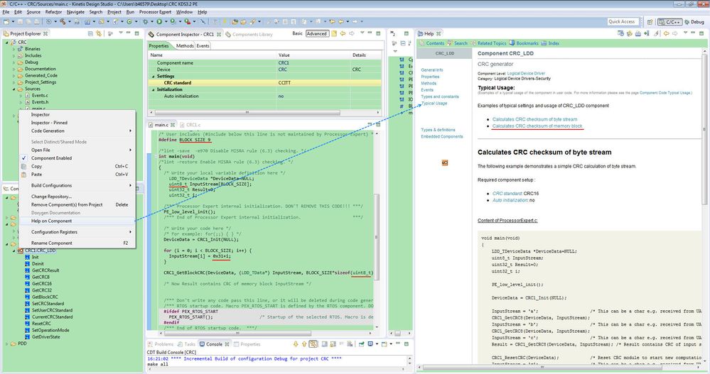

Robin_Shen
Hi Walter,
You can refer the Typical Usage of Component CRC_LDD.
Then I can get the result: 0x29B1

walter_gallegos
Hi Robin, thank you for answer.
Yes, I check block CRC work as expected but byte to byte apparently not.
First CRC is :  0x6856
Second CRC is : 0x29b1
Due firmware constraints we prefer use CRC_GetCRC16.
We can modify to process CRC as block but both CRC must be equal, correct ?

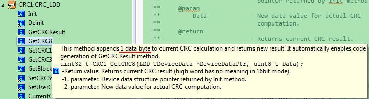

Hi Walter,
If you want the CRC work byte to byte, you need use CRC1_GetCRC8.
  CRC1_ResetCRC(DeviceData);
  for (i = 0; i < sizeof(dat)-1; i++) {
    crc = CRC1_GetCRC8(DeviceData,dat[i]);
Robin

walter_gallegos
Hi Robin,
Thank you for your support,
My apologies, I misunderstand the function name considering GetCRC16 as a CRC in 16 bits and not a CRC with 16 bit data.
So, to calc a CRC-CCITT byte to byte I need set up the CRC module for 16 bits with polynomial and seed in 16 bits but use the module calling GetCRC8.
Walter
