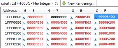

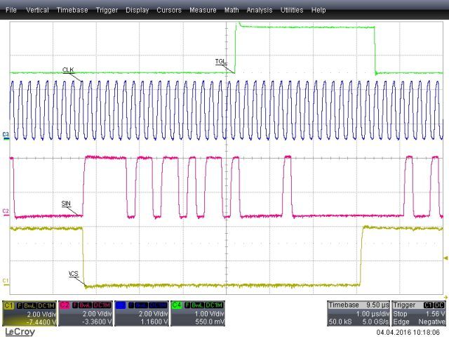

As you see, SPI1CTAR0 = 0xF8000000 - so frame= 32-bit, inact.low, lead.edge
but despite this setting I get two 16 bit frames (signal TGL below is toggled on each SPI1 Interrupt)
Scope screen shot shows a data frame starting with 0xfb.... - in the rxbuf we see high words with 0xfb... and low words with low byte equal to zero as the PCM1804 sends only 24 conversion bits and 8 zeros:

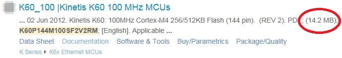

But the best comes now - I've just downloaded K60P144M100SF2V2RM.pdf from NXP - link:
http://cache.nxp.com/files/32bit/doc/ref_manual/K60P144M100SF2V2RM.pdf?fpsp=1&WT_TYPE=Reference Manuals&WT_VENDOR=FREESCALE&WT_FILE_FORMAT=pdf&WT_ASSET=Documentation&fileExt=.pdf
This time it is 20.5MB big !! - despite that you see:
So I have now 3 Versions:
      14.229KB - downloaded 2014-03-05
      13.853KB - downloaded 2016-02-10
      20.502KB - downloaded 2016-03-31
When you open these files in an editor, you see that the content is different - one can only hope that the pdf view / printout will be the same - but nobody can check it page by page...
