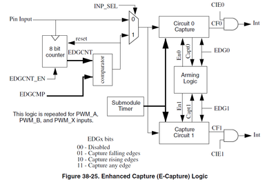

I am using TWRKV46F150M evaluation board.
I'm testing PWM input capture by configuring PWMA submodule 0 A and B pins to capture input pulses. A0 and A1 captures rising and falling edges of PWM (on time). B0 and B1 captures two consecutive falling edges (period). Interrupt triggered by capture A0.
Submodule 2 is configured to generate 50 kHz PWM signal with 20% duty on both pins A and B.
SM2 PWM output is connected to SM0 input capture pins.
Capture value registers are being read in the interrupt and on time and period is calculated.

Expectation is that (CVAL3-CVAL2) and (CVAL5-CVAL4) are either always positive or always negative. Also, (CVAL3-CVAL2)  must always give the on time.
Here, I am seeing that the on time and period are positive in some captures and negative value in the others. Also, in some cases, (CVAL3-CVAL2) contains the off time value.

I am trying to sense analog voltage through isolation barrier using Voltage -> PWM optocoupler IC with fixed switching frequency and varying duty based on sensed voltage. I want to use input capture to determine the magnitude of this voltage by finding duty cycle.
Code is written to capture both duty and period of each PWM cycle to calculate the voltage accurately.
I have used function generator and the actual PWM from IC signal to perform input capture. Results are same as posted above.
In the block diagram, there are two capture circuits. Is there a specific order in which the captured values are stored in the CAPVAL registers? If interrupt is chosen for a specific edge, is it possible that the other capture values are updated after CAPVAL registers are read in the interrupt?

After doing some more research on the variations, I read that when a module is being used for PWM generation, its timer counts up to the modulus value used to specify the PWM frequency and then is re-initialized. Therefore, using this timer for input captures on one of the other pins (for example, PWM_X) has limited utility since it does not count through all of the numbers and the timer reset represents a discontinuity in the 16 bit number range.
So I suggest you use the FTM module for input capture since it also has SDK examples, in fact the ftm_dual_edge_capture already prints the period if you put it in a loop. So it would only be calculating the duty cycle.

In the reference manual section 37.5.1.6 Enhanced Capture Capabilities (E-Capture), it is mentioned, "By simply programming the desired edge of each capture circuit, period and pulse width of an input signal can easily be measured without the requirement to re-arm the circuit.". This means this feature would have been tested by your feature test team.
Request you to please check with them and send the sample code.
