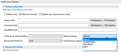

There is the 'Restart' button
It does kind of the same. The reason is that each debug probe/connection might handle the 'reset' or 'restart' differently.
For example in the LinkServer connection you could fine tune the reset behaviour:
