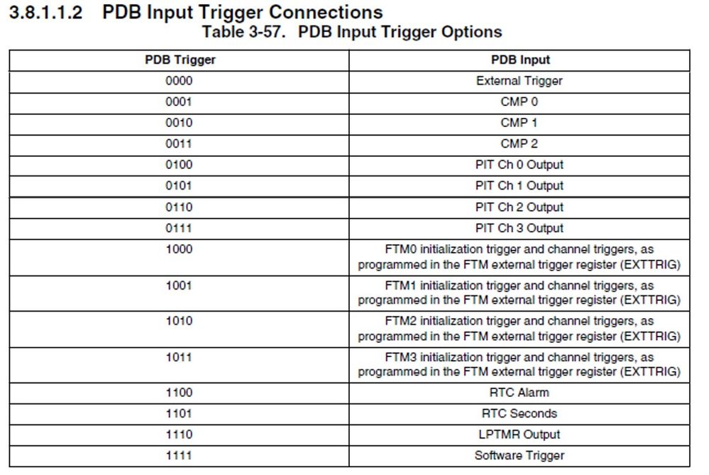

Now, I want to configure the PDB using an external trigger input souce (EXTRG pin).
Up to 15 trigger input sources are available and user-selectable through the TRGSEL bits of
the PDB Status and Control register.
In the K64 Sub-Family Reference Manual, Chapter 39 PDB , section 39.3.1 PDBx_SC,
to set up the TRGSEL bits, it is written to "refer to the chip configuration
details for the actual PDB input trigger connections" ... Where can I find these information ?
Nadine

isaacavila
Hello Nadine,
This chip-specific information in mainly located in Chapter 3: Chip Configuration, for this case, in section 3.8.1.1.2 PDB Input trigger connection there is a table (Table 3-57) that refers to all of these input triggers:
All other chip-specific information like back-to-back acknowledgement connnections, PDB interconnections and other are also located in this section.
I hope this can help you!
Isaac Avila
