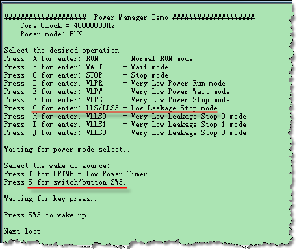

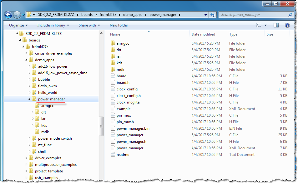

Robin_Shen
Please try to test the power_manager in SDK_2.2_FRDM-KL27Z.
...\SDK_2.2_FRDM-KL27Z\boards\frdmkl27z\demo_apps\power_manager
Robin

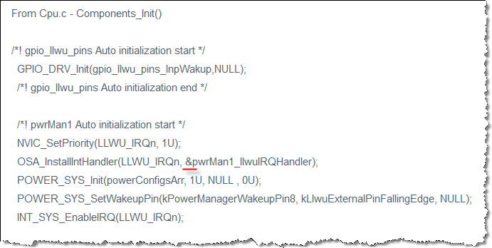

Robin_Shen
I am not sure if it was caused by the difference below.
The OSA_InstallIntHandler in Components_Init.
Robin
5,993 Views
thomas_haugen
No, I tried to remove the &, it made no difference. I had to comment out the //OSA_InstallIntHandler then add the default function handler, void LLWU_IRQHandler(void), into Events.c.
I'm installing handlers for TPM0, I2C0, I2C1, UART2 and LPUART1 with OSA_InstallIntHandler(). It works fine, but not for the LLWU.
Thomas
