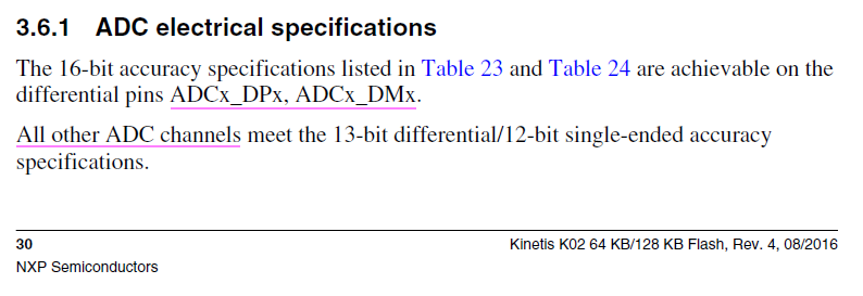

From the K02P64M100SFA DataSheet you can find below description:

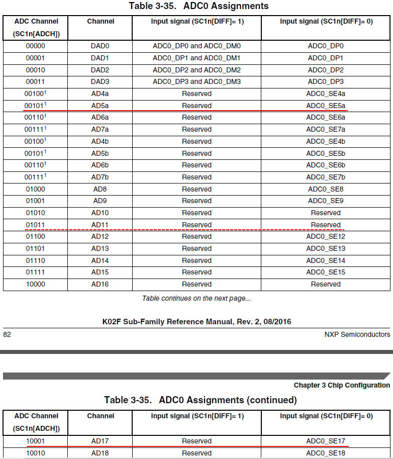

So the analog channel 5 and 11(17) only meet the 13-bit differential/12-bit single-ended accuracy specifications.

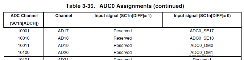

And the analog channel 11 is not available for your chip. I think it's analog channel 17.

If you input the singal at PTE17, then AD channel 21 should be configured as below:
ADC0->SC1[0]=ADC_SC1_ADCH(0x15);
ADC0->SC1[1]=ADC_SC1_ADCH(0x15);  //using PTE17 as ADC0_DM1

Thank you Robin. I was sure there was something wrong there, i was confused with the differential config. It seems that the ADC doesn't really have the precision of a 16bit ADC. I get now small errors in readings up to 20.
I hope that recording audio in 16bit mode will be better than 12bit.
4,846 Views
Robin_Shen
Hi Gnichi,
Have you try to use these three ADC input pins: ADC0_DP0, ADC0_DM0, ADC0_DP3. Will all these pins get 20LSB error?
16 bit is the resolution of ADC, about the precision please read the "Table 24. 16-bit ADC characteristics" in DataSheet.
And be aware of "Reference-voltage noise" and "Analog-input signal noise" in AN5250.
