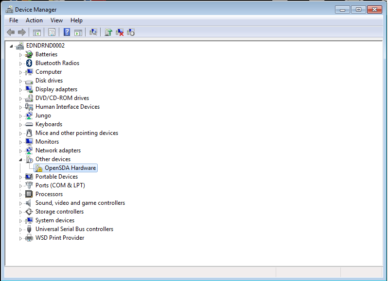

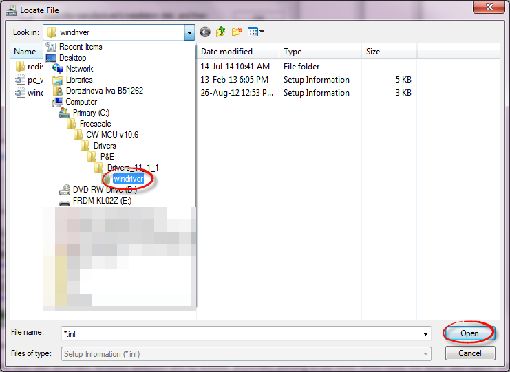

I have followed all the tutorials/posts/freescale opensda guides for installing the debug app and have followed them to the letter, however my freedom board driver does not successfully install when enumerating.
As far as I'm aware my board is up to date (see below)
(boot-loader V 1.11, debug V 1.14)
I have also installed the latest driver (V11.1) which has installed on my C drive.
I have tried updating the driver both with automatic windows detection and by browse, physically pointing to the folder which holds the driver, with neither working. Has anyone else had this problem/no how to fix it.

In device manager its just appears in other devices with the driver status being "The drivers for this device are not installed. (Code 28)"

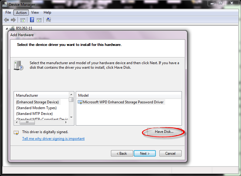

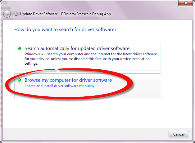

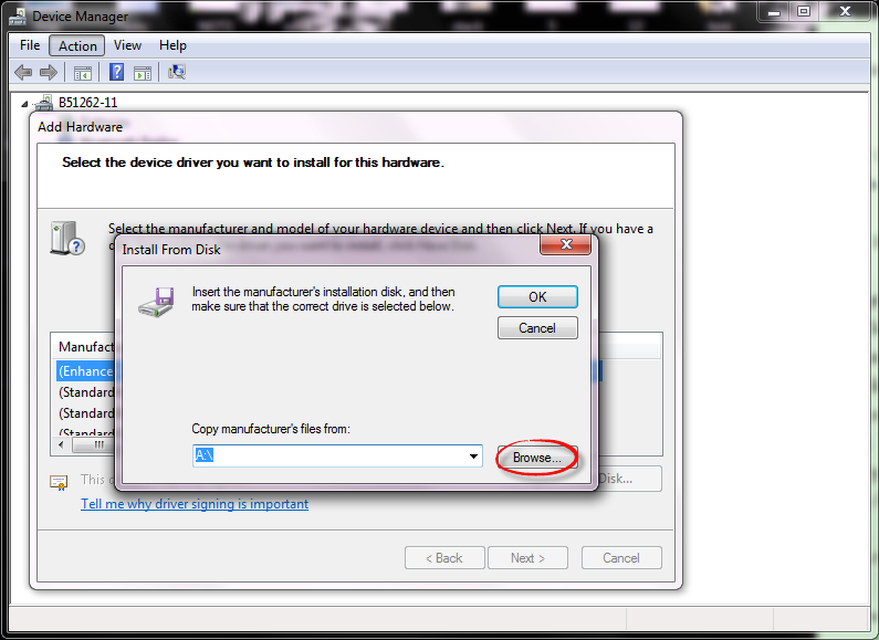

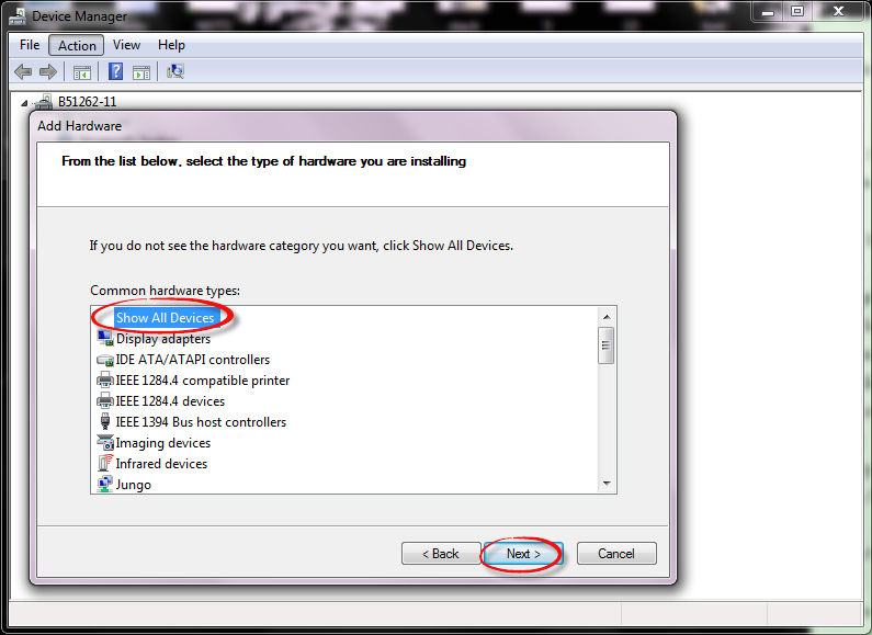

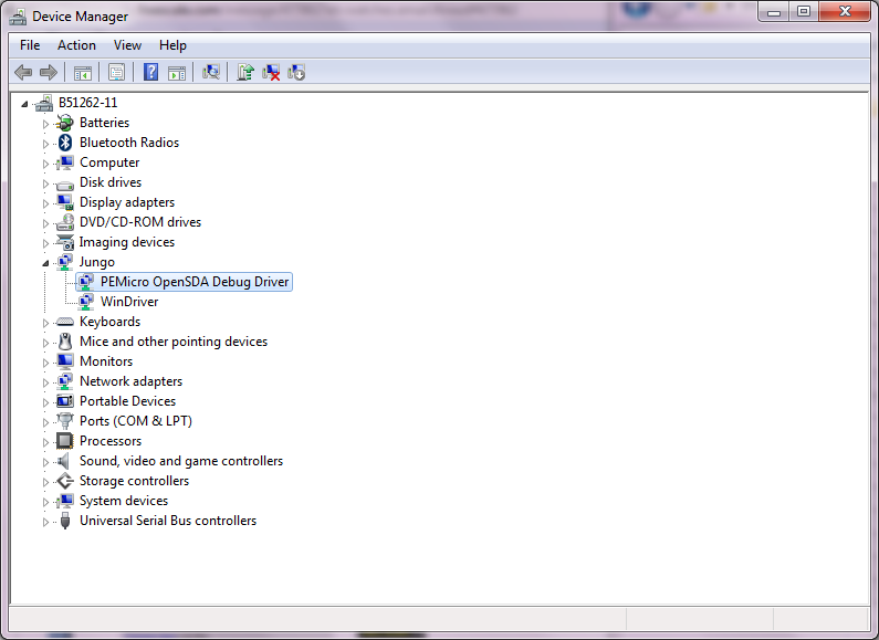

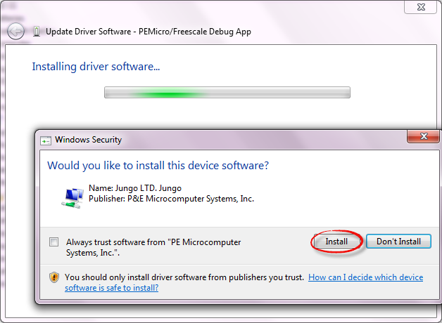

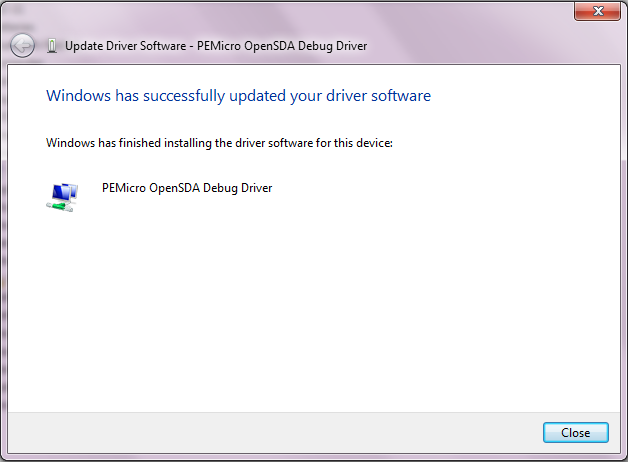

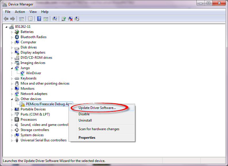

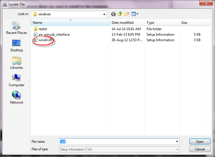

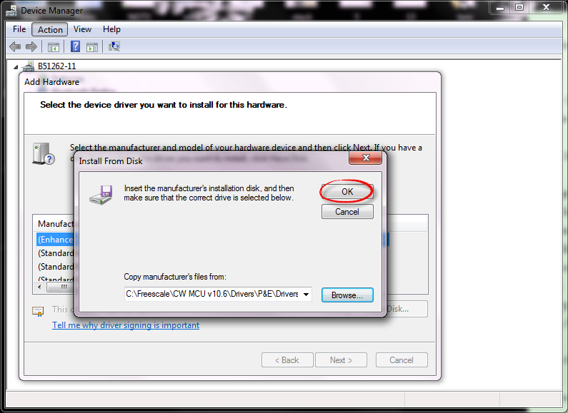

ivadorazinova
Dear sam moreland,
I created screenshots for you. Please, follow it.
I hope it helps you,
Iva

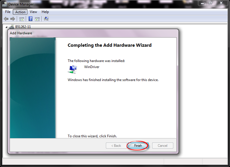

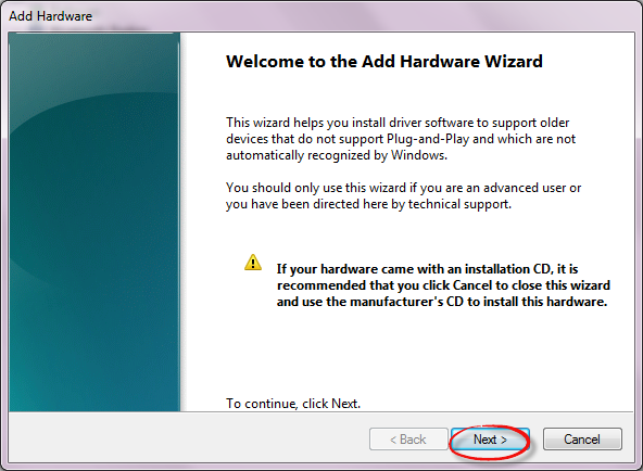

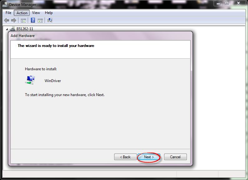

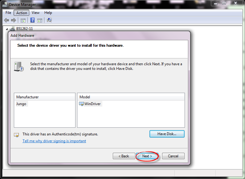

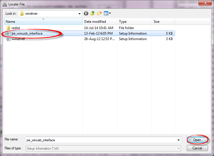

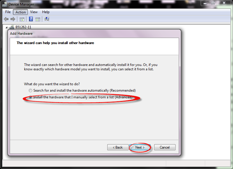

ivadorazinova
Hi sam moreland,
yes. You also  need to install WinDriver in Jungo. The procedure is the same, but you choose WinDriver.
Here is step by step manual:
Iva

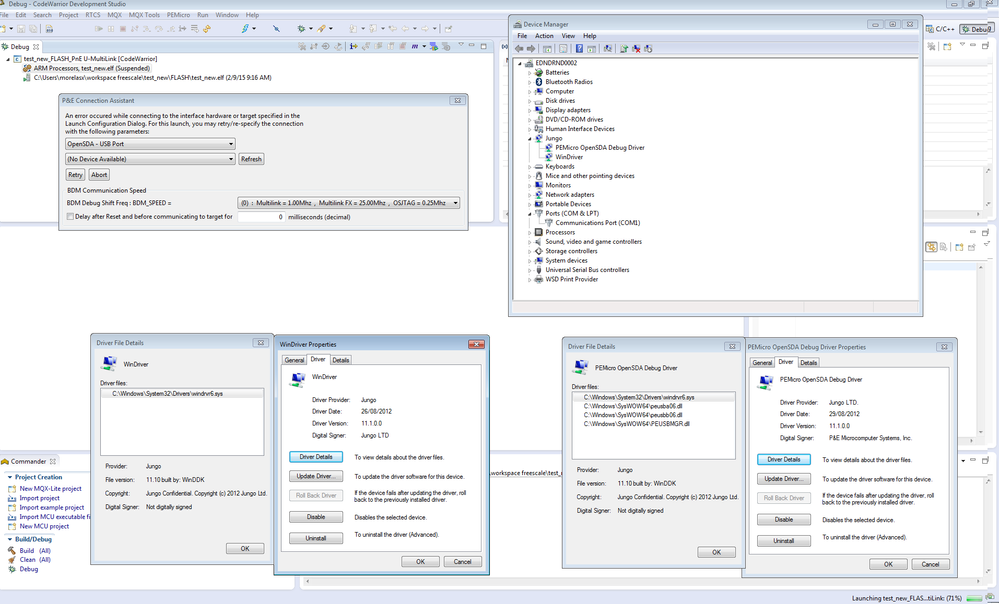

sammoreland
Im afraid that still isn't working, I originally had that driver installed and uninstalled it when testing different configurations. Please see the screenshot below. I am also unable to take down firewalls/anti-virus at work as it is against company policy. device man.png

ivadorazinova
Hi sam moreland,
yes.  The drivers are ok.
Please, also, did you try the board on another computer or did you try another board?
Iva

adriancano
Your Device Manager does not show the WinDriver under the Jungo tree, please check this post it might be useful:
Fixing the USB Drivers | MCU on Eclipse
Hope this information can help you
