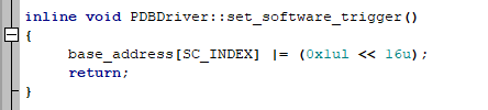

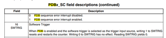

As I am working on a project, so I used the Programmable Delay Block (PDB) module and as a part of the implementation, I am not able to set (to write "1") the Software Trigger [SWTRIG] Bit in Status and Control Register (PDBx_SC) even after I enabled the PDB by writing "1" to PDB Enable Bit (PDBEN) and also selected the Trigger Input Source Select (TRGSEL) as Software trigger which is as mentioned in the RM shown below:

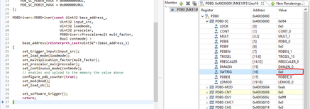

Also, please find the below snips of debugging and the function used to set the SWTRIG Bit "set_software_trigger()":
 Please provide me any inputs on the above issue.

It is normal to read '0'
It will however have performed the trigger when written with '1'.

It is not possible to read back a '1' - whether it is momentarily set or not is of no significance; the write of '1' is what triggers the event.
You can verify that the event was triggered by the completion of the action that was triggered.
