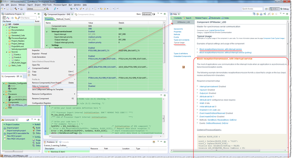

Robin_Shen
Hi Ben,
Have you try to test the Typical Usage "Block reception/transmission, with interrupt service " of SPIMaster_LDD.
Test it on FRDM-K20D50M board, I was able to observe the SPI waveform on oscilloscope.
Robin
