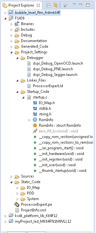

Can you do a full text search for 'UnhandledInterrupt' and/or 'FTM3_IRQHandler' thru all files in the project and find a table full of vectors?  Per that thread you referenced, you are looking for a startup_MK64(something).S file in a 'Startup_Code' folder (under Project_Settings), and if your handler-name matches the one in that file it should indeed overload the default def_irq_handler....

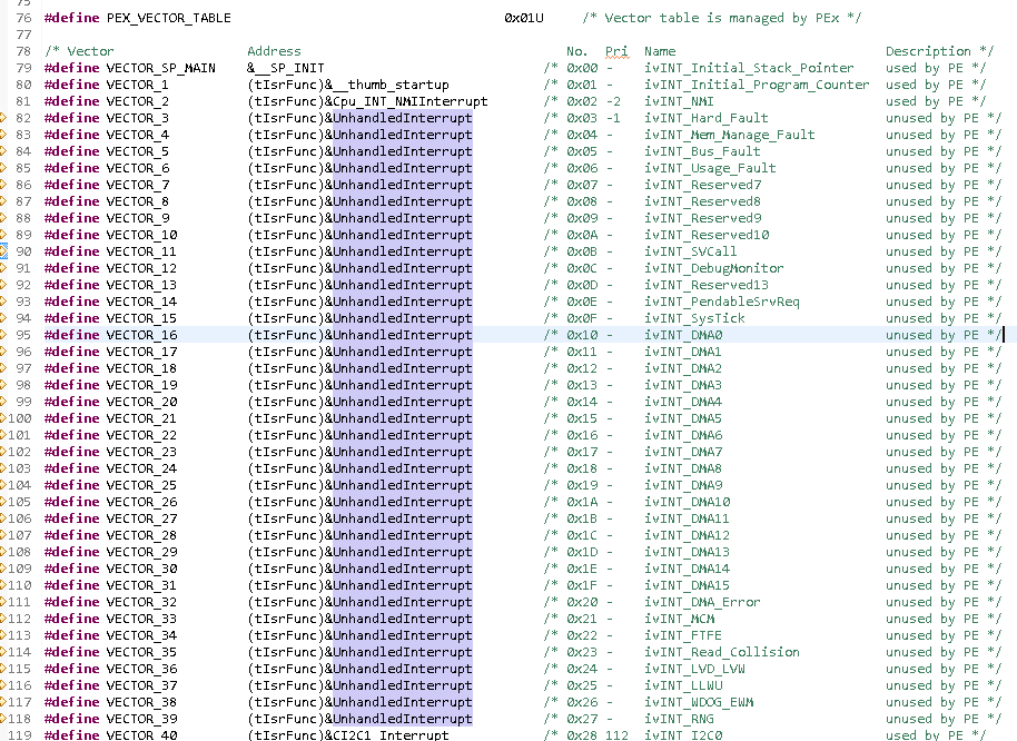

No such files exist anywhere in my project tree. I did a search on "FTM3_IRQHandler" and nothing came up. When i performed a search on "UnhandledInterrupt",  It pointed me to the Vector_Config.h and vector.c files. In the Vector_Config.h file i found the following vector definitions. I believe all i need to do is to replace the "UnhandledInterrupt" text with the my interrupt name. I will test this theory on Monday when i'm in the office and report back to you. Earl, Thank you very much for help.
-Project tree

Thanks you for your help. After searching around i wrote a function, enable_irq(INT_FTM3-16);,  and set the interrupt priority, NVICIP87=0x50;. Now, every time i ran the code the program kept pointing me to the below piece of code in the Vectors.c file.
PE_ISR(UnhandledInterrupt)
PE_DEBUGHALT();
Vu

Sounds like your interrupt handler label did NOT 'overload' an existing weak name (so your newly enabled interrupt falls to the dummy handler), and you are going to have to find your vector table definition code and see that your address DOES get there! Which was your original question(!), but I can't be of much help as I am not familiar with either KDS or PE.
Or of course the NVIC vector isn't what you expected.  DO make sure you have written from the right vector table definition; every Kinetis part is different.
