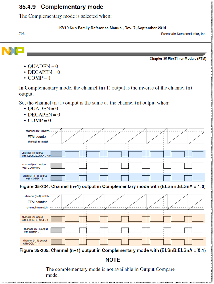

I am programming KV10Z32V kit on the Kinetis Studio. I am trying to set up 2 PWMs at the same frequency on Channel0 and Channel1 of the FTM0 module. Additionally, I want to set an 180-degree phase difference between these PWM signals. Is this possible? I couldn’t find anything related to this on the documents.
Thanks.

Hi Sezai,
You can find the "35.4.9 Complementary mode" in KV10P48M75RM.

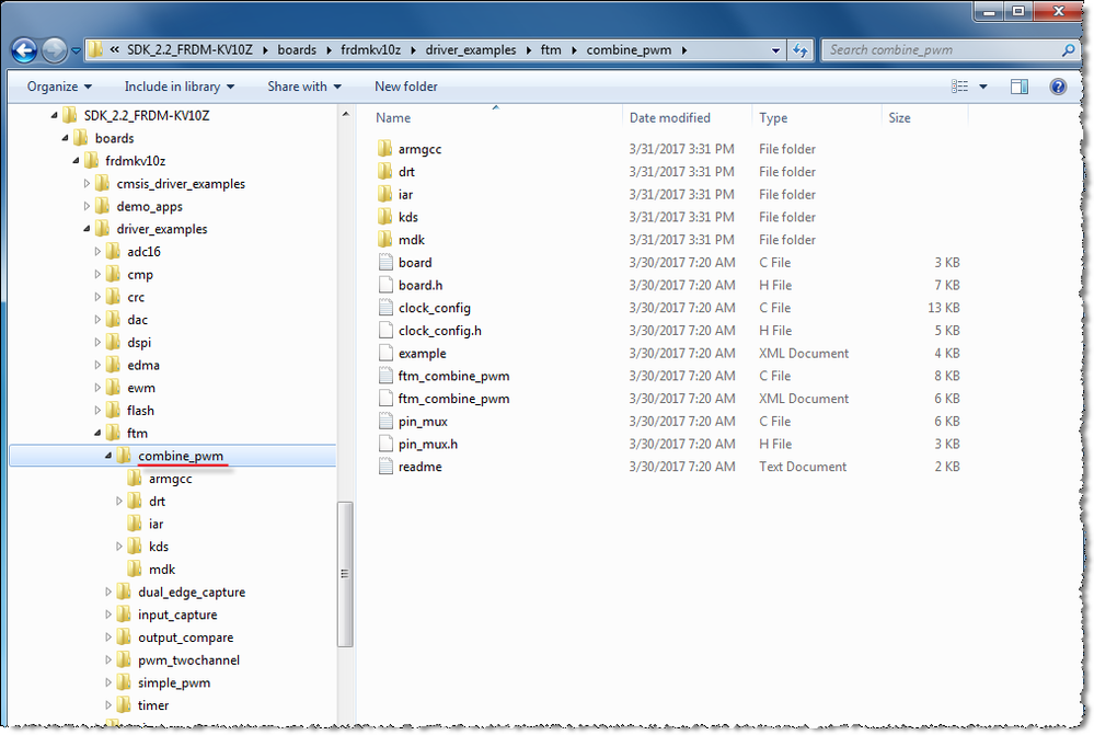

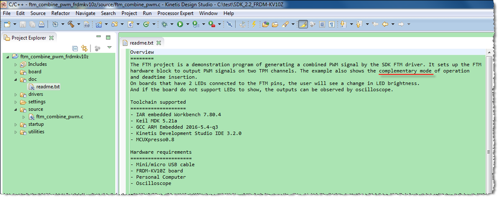

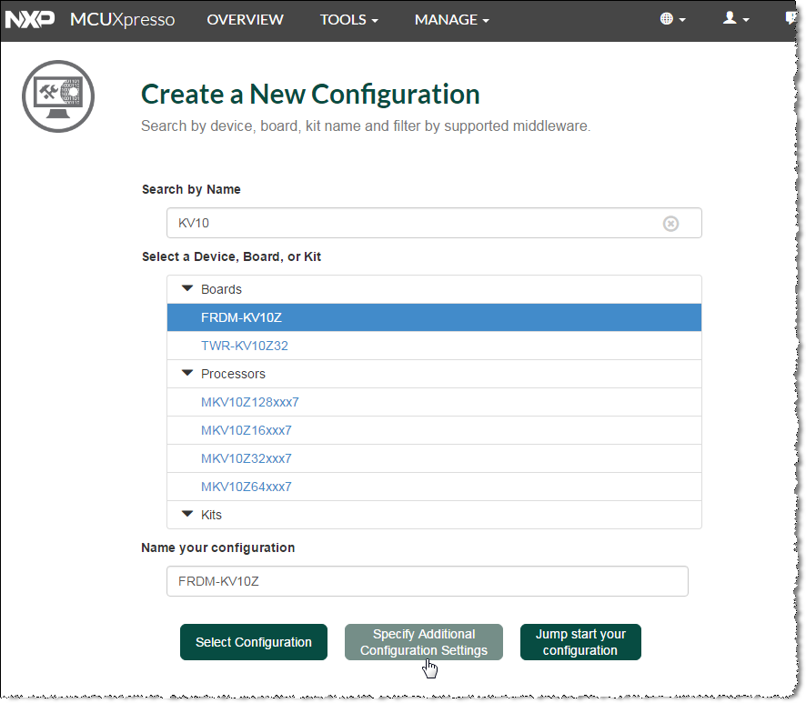

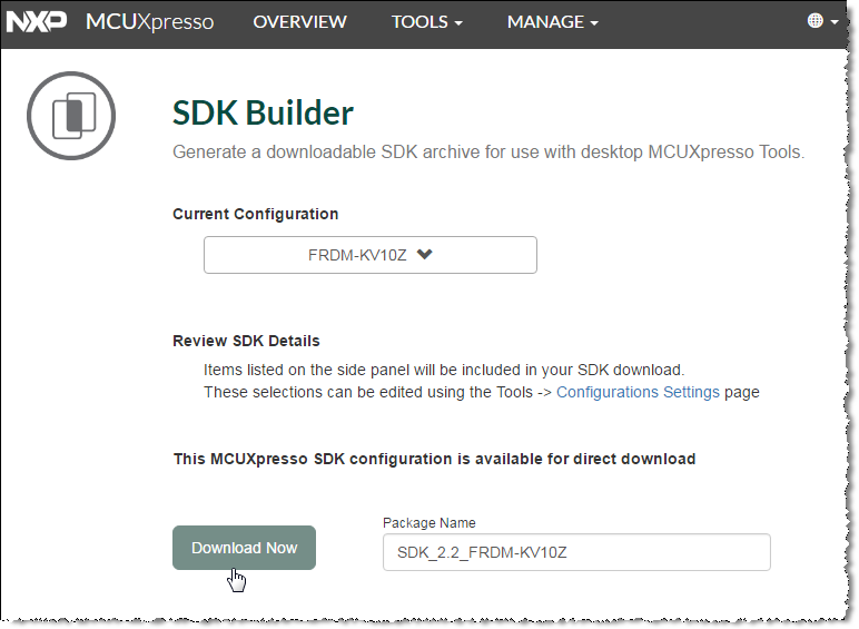

You can also refer the combine_pwm example in SDK_2.2_FRDM-KV10Z. It shows the complementary mode.
