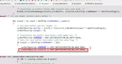

After analyzing this problem, I'm not entirely sure that setting the flag, in the length section, would be the best option, since is possible that after a frame fails, all the frame is not discarded and this could cause corruption in the following ones.
Could you try adding this flag in the ENET_SetRxBufferDescriptors in the following section?

lh_dan
Alexis,
I tested out the code change that you suggested (and removed my previous change). It did not fix the issue that I am seeing.
Looking at the fix you suggested, wouldn't this just set the last flag at initialization but not on any later transaction? When ENET_ReleaseRxBuffer() releases the buffer it will always clear the last flag.
            /* Clears status including the owner flag. */
            blockBuffDescrip->control &= ENET_BUFFDESCRIPTOR_RX_WRAP_MASK;
            /* Sets the receive buffer descriptor with the empty flag. */
            blockBuffDescrip->control |= ENET_BUFFDESCRIPTOR_RX_EMPTY_MASK;

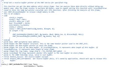

One interesting thing that I noticed is that the comments for ENET_GetRxBuffer show that ENET_GetRxBuffer & ENET_ReleaseRxBuffer should not be called when when length is zero. However the actual code does exactly this.
