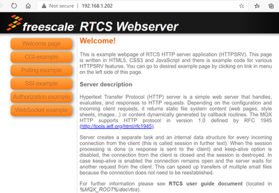

I only have MQX 4.2 installed.  I can see below page when I access 192.168.1.202.
Is this what you can see in your side?
 I would suggest you read the readme file first, which is in the source folder.

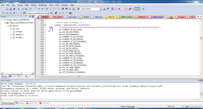

Finally, I found the function after which the data is getting changed. Here I'm attaching the screenshot
One thing I observed that, after a request received by the server, immediately data is getting updated into the buffer named "str", so now my question is how can I change the values of the buffer "str" manually because it keeps changing continuously. Any help will be really appreciated!

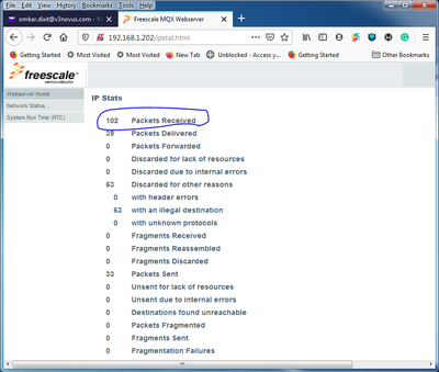

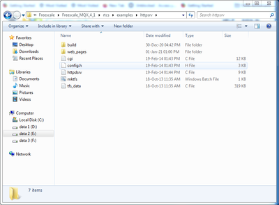

In my case, I'm using MQX RTOS 4.1 in which unfortunately I didn't found the readme file. I'm attaching the screenshots below.
Basically, my task is to change the area which I have circled in the second screenshot.
