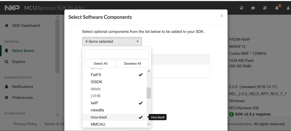

miduo
The KDS is declining and we do not update it any more. We recommend the SDK which had a new release. You may download it and including the Software Components as below:
