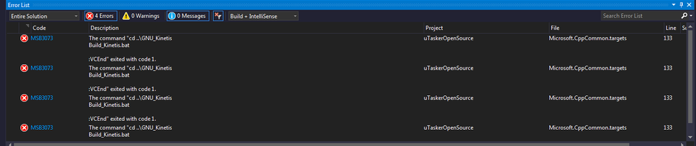

Regarding your simulator. I had some issues trying to compile on my work machine...the make file was failing with a generic error and I tried a few different uTasker projects I had on file and they both had the same error. Although I can compile and run the project successfully on my home PC. See below error..

The simulator failure is a post build bat file that can't be execute - the simulator is still OK and operational.
There are two possible explanations:
1. You are using the "Kinetis" target on one machine and the "Kinetis plus GCC build" target on the other. The one not trying to do a post build step is then not showing the error message.
2. On one machine the post build step is working and on the other it is not (check the bat file called to see that it knows the path of your GCC toolchain).
If you don't want the post build step select the target without it, and in each case the simulator will still run since teh post build step is needed only to generate an object for the HW target.
