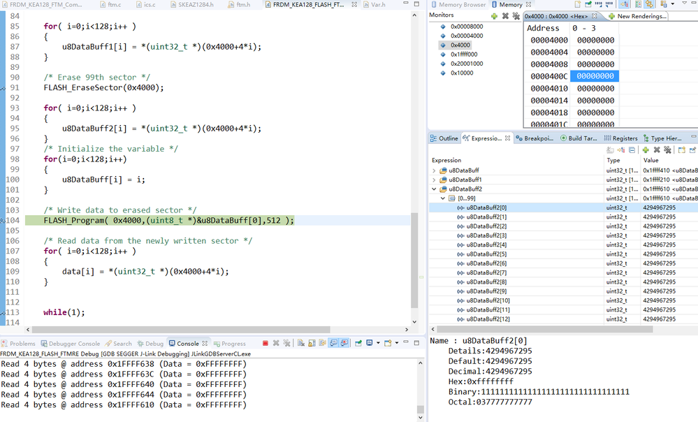

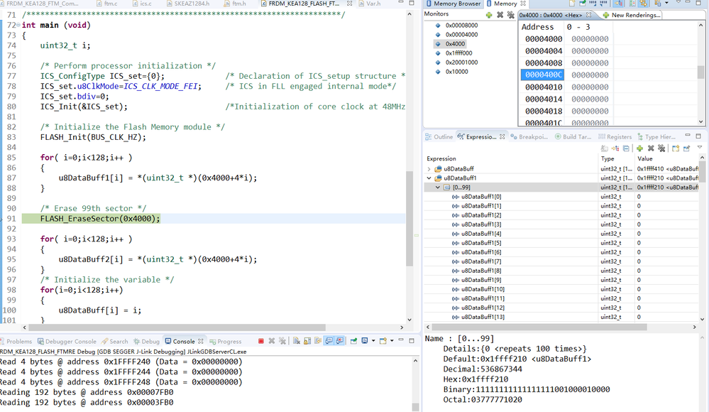

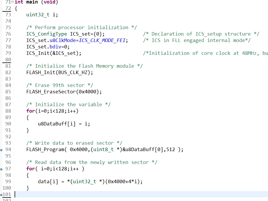

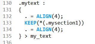

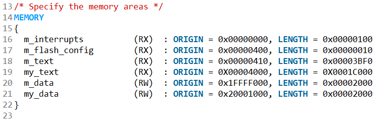

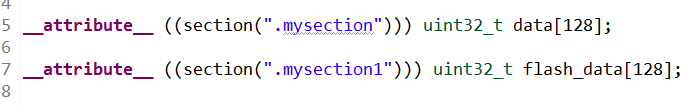

section setting
What my problem is that I can erase and program the sector after 0x4000 when there is no flash_data's defination and .mytext section setting. And once I allocate flash_data in the .mytext section, I can't erase and program the sector after 0x4000 anymore. Please help. Project attached.

kerryzhou
Hi Yan Sun,
     How do you test it, do you just debug the code and check the memory data?

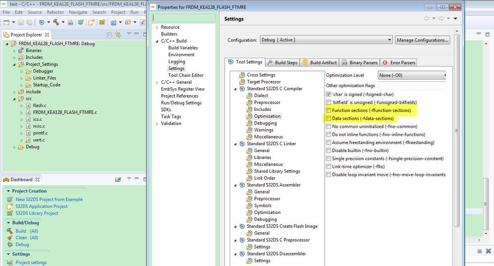

    If yes, it's the IDE's problem, when you use the __attribute__ ((section(".mysection1"))) uint32_t flash_data[128]; The IDE seems protect the memory according address.

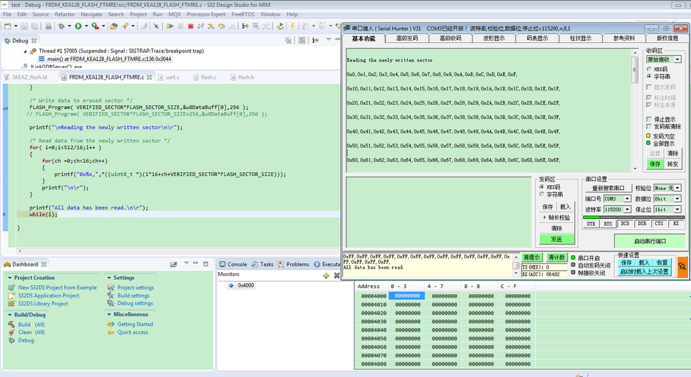

  Actually, I also use the printf to see the data, I find the flash erase and program all works.
   Please check my test result and the attached code:
1. Erase
You can find the memory still 0 after erase, but the printf data is 0XFF, it's correct.
2. Program.
Please use my attached project.
In the optimization, please don't select the data section, do it like the following code:
4,623 Views
ayanosun
我在每个节点前后用数组都出来试了一下,结果如下:
擦除前
擦除后
写入后
就结果来看好像擦除是可以的,但是写入并没有成功。

ayanosun
这个我再多验证一下。还请教一个问题,就是将函数拷到RAM运行是怎么实现的,还是说就是直接将函数用__attribute__分配到ram中就行了?谢谢
4,623 Views
kerryzhou
对的,其实和flash的操作一样,就是在ld文件中分配的区域是RAM区域。
