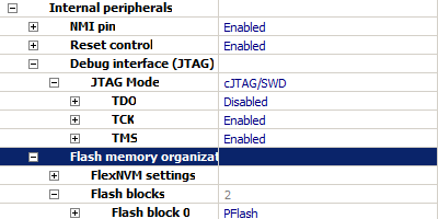

Now I developed a K10 prototype using the same SWD connections but it doesn't work, I went in to the SWD configuration as follows:
Where using the pin RESET_b connected to RST_TGTMCU... But after seeing the following table on the K10_RM, I cut off that trace (SWD Debug Port column):
I did not wire-up the TRACE_SWO pin since the KL25 doesn't use it, for me it seems that if I do not wire TRACE_SWO I will loose trace functionality not make my SWD connection useless.
My SWD does not work yet... shoould I wire-up the TRACE SWO signal to make it work? what is going on???

The min.single SWD interface is VDD, VSS, SWD_DATA, SWD_CLK. But you might need other function, you need to add other pins, such as trace_swo. So I suggest you keep SWD pin assignment. Thanks.

I think you should wire up the TRACE_SWO pin and I've also included the KQRUG (Kinetis Peripheral Module Quick Reference) which explain standard debug interface design in 2.5.3 Debug interface.
Please refer to it for details.
