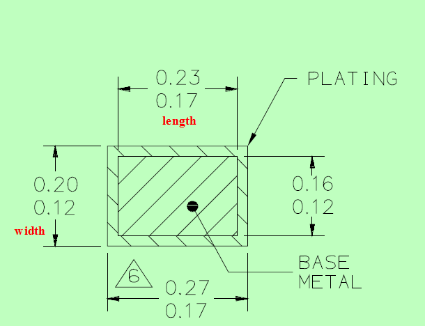

I'm using MKL15Z128.but I can't understand the mean of MKL15 package.
in the picture from MKL15Z128 package document,eyery side has two numbers. Why?why has two numbers every side?
which number should be used in my package?

As you know, every pin of chip has a plating layer on real metal. The dimension of outside line is plating dimension. The internal dimension of inside line is metal dimension.

   Every side has two numbers, this two number are the size range,  it is the mechanical tolerance.
   When you draw your chip package, if your pin pitch is less 0.4, you should keep your width below 0.2, otherwise, the pin each to other maybe connected. But if your pin pitch is bigger than 0.4, you can draw your pin width a little
bigger than 0.2, for a food contact with silicon.
   About the length, you can draw it bigger than 0.23, for soldering.

oh,I see.Thank you.

The two dimensions on each side is mechanical tolerance.
