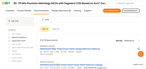

I have successfully implemented metering code(AN12837SW) on KM35 MCU. How can i do for KM34 MCU using MCUxpresso IDE, Which Application note software is needed for that or can i port AN12837SW for KM34 MCU?
1,313 Views
Pablo_Ramos
Hi @Bhumika
You can find a similar Reference Design Guide for the KM34 in the documentation section from KM3x page
Arm® Cortex®-M0+|Kinetis® KM3x 50-75 MHz 32-bit MCUs | NXP Semiconductors
Also, you can find usefully the migration guide from the KN34 to KN35:
KM35Z512 Migration Guide (nxp.com)
