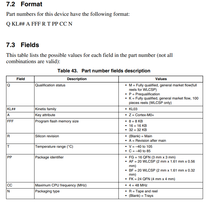

I need to understand the marking code about MKL03Z32VFK4,( mark par , lot production and data code).

I wanted understanding if the MCU  MKL03Z32VFK4 is marked as M03T5V.

Hello Paolo,
The part number sections are described in the datasheet as follows:
Please let me know if you have further questions.
Sabina

I need to understand the marking code write on the package and the data code.

Hi Paolo,
The first  line  of the chip marking will read M03T5V
The second line is confidential so I am not able to provide specifics but it contains the date code.
