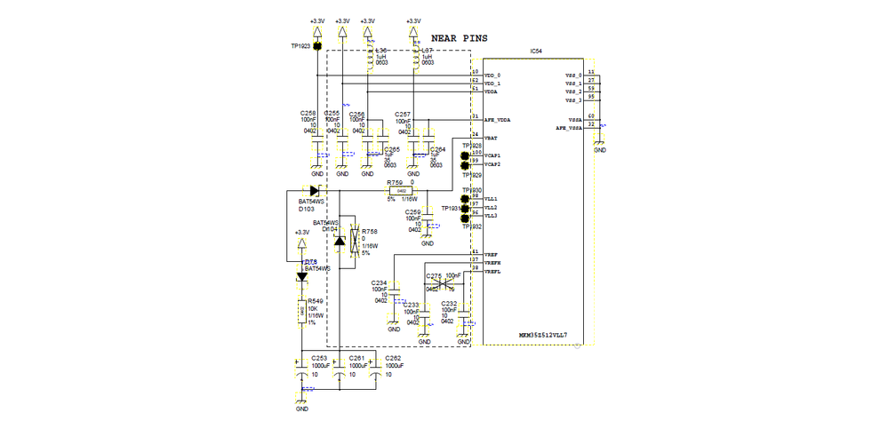

I'm using the KM35 microcontroller (MKM35Z512VLL7).
On the RTC_BAT VBAT pin I have a 3mF supercap that is charged by the uC VDD +3.3V supply voltage using a 10K resistor (R549 see schematic).
When VDD is OFF (PCBA switch off), the VBAT voltage discharges very slowly (IDD_VBAT is uA range).
When VBAT falls below +1.71V (operating requrements), the uC is between operating requirements and operating ratings (-0.3V < VBAT < 1.71V).
what happens to the uC when VBAT < 1.71V? Can the uC be damaged?

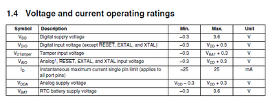

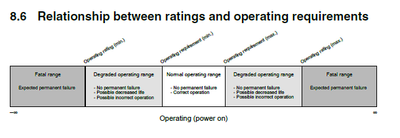

The question arises by reading paragraph 8.6 of the data sheet

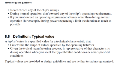

moreover, in paragraph 8.7 it is written

Celeste_Liu
Hello @beste-ivan ,
Thanks for your post. And sorry for the late reply.
As you can see in the datasheet , when VBAT < 1.71V, the microcontroller enters the degraded operating range. It won't suffer immediate permanent failure. However, according to the guidelines in the data sheet, if the VBAT remains in this voltage range for a long time, it may cause abnormal functionality of the microcontroller (such as inaccurate RTC timing, etc.). Moreover, the long term abnormal operating state may bring potential risks like decreased device life. Therefore, it's best to avoid having the VBAT of the microcontroller stay in this voltage range for extended periods. If that's not possible, the duration in this voltage range should be minimized as much as you can.
BRs,
Celeste
