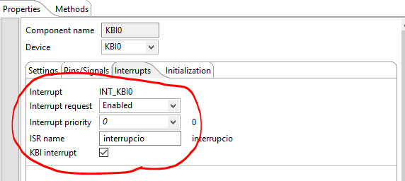

Hello everyone and firstly, I woul like say to this communityt THANKS! because of your help, you always helps me! So
In my Jobs we are trying to make a library for use of KBI pheripherial. We know that there's a low level kbi component, and we got that It work successfully, However we want use KBI without add the component, I mean, using low level registers, We got do it! but not all, we have a initialize code (clear kbi flags, init clock for this, edge selection etc...) and we use the PE_ISR macro to specify our interrupt, but it doesn't work!, it works only when add the component and mark "Interrupt" option, just like the image below:
So KBI0 only work (with our code) and checking "Inerrupt resuest: Enabled", but in our code we enable the KBI interrupt in the KBI0_SC register, but doesn't work, we need add the component so that enable that interrupt, why?¿
This is our init code:

Have we do something else apart of initial code ?

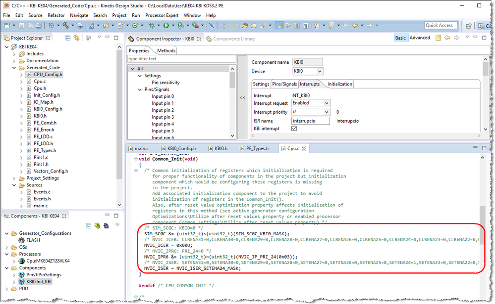

Robin_Shen
Hi Ricard Comas,
Maybe you forget add these codes:
NVIC setting and clock gate enable
Robin

ricardcomas
By the way, I trying to configure PORTA0 for the KBI0
2,993 Views
ricardcomas
Hi robi what's up?
Thnks for you quick answer, I just put that code on the init KBI function, It doens't work yet though, I had read about NVIC (interrupts) in the datasheet, nevertheless it suggest us visit arm website for learn configure NVIC.
I don't get KBI works... :smileysad: Is there something else to be programmed?
Thanks lot!
