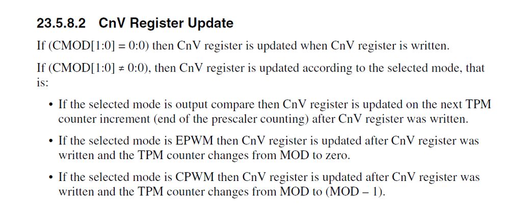

My problem is, I can't change the duty cycle of the TPM. I start the PWM signal in "TPM_DRV_PwmStart(0, &motor1, 0)" outside the loop (while) and then, inside the loop, I tried to change de duty cycle with "motor1.uDutyCyclePercent = some value" but not worked. I tried also to stop the PWM and start again inside the loop, but still didn't work.
I tried everything, but the duty cycle of the PWM don't change. I tried to create a simple code, without PID calculations, but happened the same issue. The only way to change it is putting a value outside the loop, at the beginning of the code.
How can I change it INSIDE the loop, constantly?

  About the TPM duty change, please also refer to the RM:
Wish it helps you!

kerryzhou
Hi Nicolas Ludwig,
    Do you mean, you delete the getchar code, then just modify the updatedDutycycle ?
  Is it right?
  If yes, you can't change it very quickly in the while(1), just as I told you in the previous reply:
 As you know, the while(1) runs very quickly, If you update the duty cycle in one PWM cycle, your output will have problems, it's totally caused by your code.
I don't know how you want to change the duty, when you want to change the duty, anyway, I think you won't change the duty a lot of time just in one PWM cycle.
You need to give an event to trigger the duty change things, instead of just always changes it in the while(1) directly.
take an example:
while(1)
  if(change duty flag==1)
    change the duty;
Now, you need to design your app, when you want to set change duty flag, and make sure it won't set just in one PWM cycle.

nícolasludwig
I think I understood what you said. My PWM frequency is 50Hz, so the PWM period is 20ms. My sample time must be greater than 20ms, right? Seems obvious, but I didn't realize it earlier.
5,879 Views
kerryzhou
Hi Nícolas Ludwig,
   Clever!
   Yes, that's what I want to say, it should be larger than 20ms, if you ware using the PWM period is 20ms.
   Please try it on your side.
