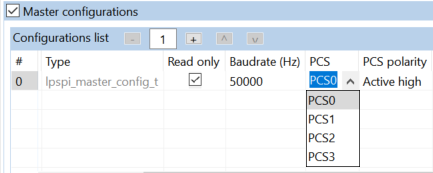

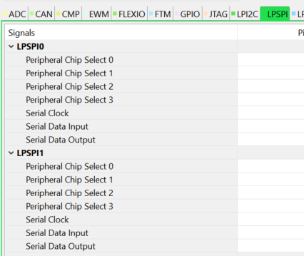

danielmartynek
Which pin are you using for the PSC of LPSPI1?
And which PSC have you selected in PE?
Have you configured the pin in the PIN Driver configuration?
BR, Daniel
6,263 Views
richard_clouse
Thank you Daniel so much for the response. I changed the PCS to 0 and it works. I thought it had to match the instance number 1.

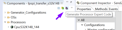

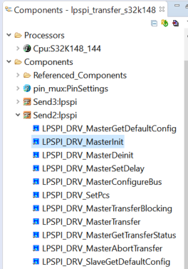

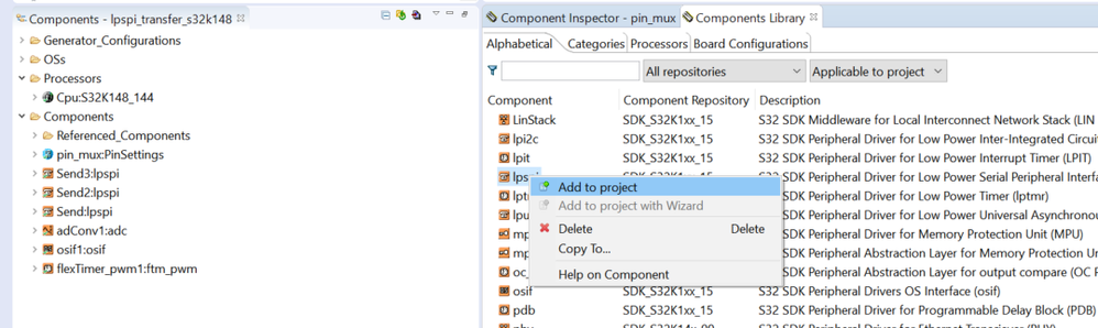

danielmartynek
Hi Richard,
Please use the PE component inspector, it should be intuitive.
Just open the PE views
Add modules
Configure them in the component inspector
Generate the code:
Drag and drop functions in the code:
Similarly for other peripherals.

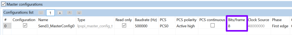

danielmartynek
There can be one SDK components for each LPSPI module.
And each LPSPI module has dedicated pins that can be used.
Please refer to S32K148_IO_Signal_Description_Input_Multiplexing.xlsx file that is attached to the reference manual.
However, one SDK component can have several configurations with different frame length as well.
