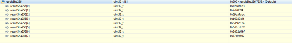

pietrodicastri
Senior Contributor II
Hei Mark
Good to find You here also.
I have tested the source code as is in the example and I expect it should work. I have here the FRDMK64 and the TOWER for the KV58.
Both of them give the same wrong result.
The HEX counterpart is here and it does not help. All of the buffers are correctly aligned.
That's the dump of the hex
If you have suggestionns are welcome.
Thank You
