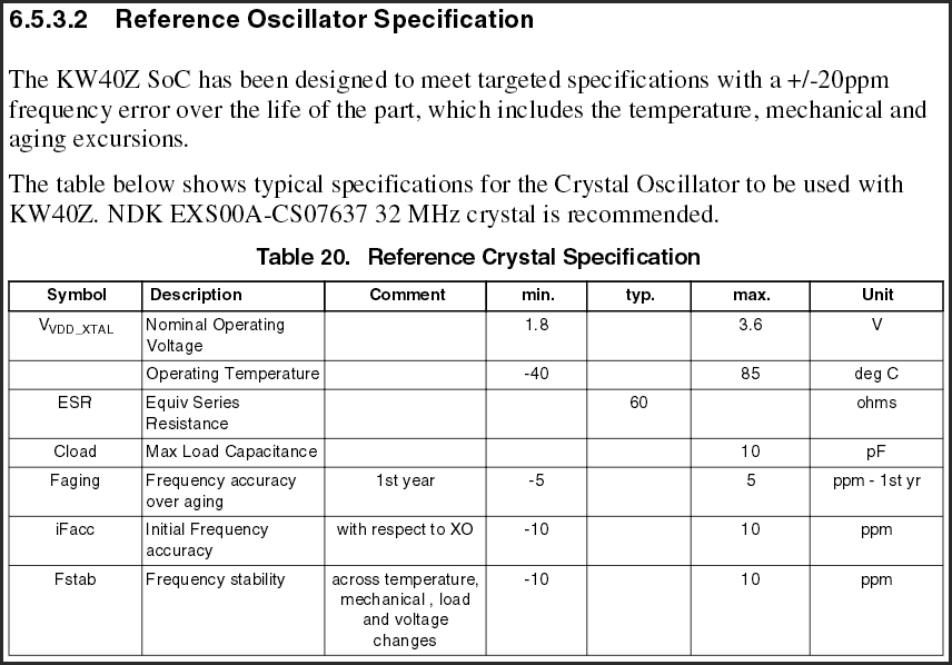

Is it possible to use a single output MEMS oscillator as the 32 MHz clock source, or must it be a crystal?

The quartz part is very sensitive as it drives all - including BLE (IEEE 802.15.4) TX RX 2.4GHz - with should be very stable in frequency and time - is possible that the chip will not start.
Also you should look closely to oscillator parameters:
http://cache.nxp.com/files/32bit/doc/data_sheet/MKW40Z160.pdf
Page 39
        Cload Max Load Capacitance 10pF (max)
 http://cache.nxp.com/files/32bit/doc/ref_manual/MKW40Z160RM.pdf
Page 1077
Crystal resonator load capacitance 9PF typical, package shunt capacitance 2.8PF

Hello Bryan Sharp:
Yes, it should be possible to use the MEMS oscillator as external 32 MHz reference for the KW40. You need to set the bit MCG_C2[EREFS] as 1 to bypass the internal oscillator and use directly the external reference.
Just make sure that your oscillator complies with the oscillator specifications as stated in the Datasheet, in particular the +/-20ppm frequency error:
