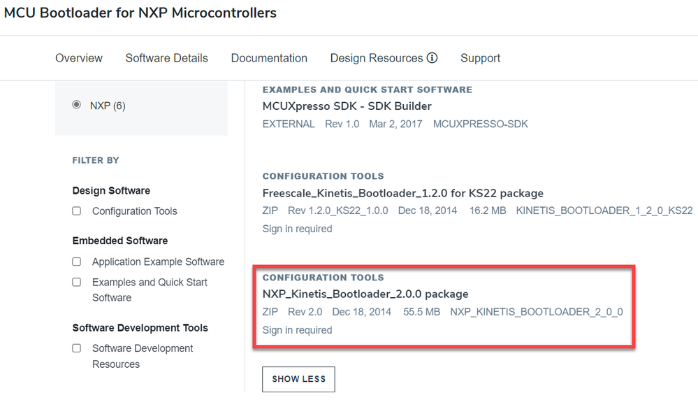

Can you try the image upgrade by using the Kinetis Flash Tool to confirm if a similar behavior is present? This tool can be downloaded from the MCU Bootloader webpage, Downloads section:
It should be included inside bin\Tools\KinetisFlashTool\win
