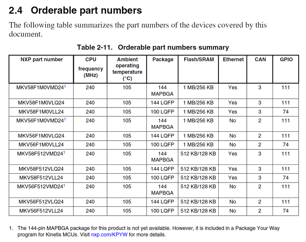

Hi:
      The MKV58F1M0VLQ24 and MKV56F1M0VLQ24,the two Chip compatible?If I dont need Ethernet,the MKV56F1M0VLQ24 can replace MKV58F1M0VLQ24?
1,131 Views
xiangjun_rong
I think that the KV56 and KV58 are  pin to pin compatible for corresponding package, the only difference is that KV56 does not have Ethernet module and only have 2 CAN modules, while the KV58 has one Ethernet and 3 CAN modules.
Hope it can help you
