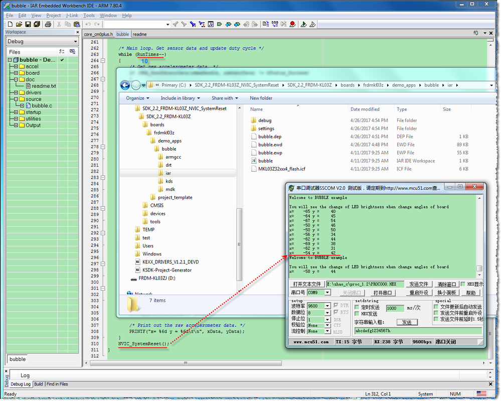

Robin_Shen
Hi Tiger,
I test the bubble demo in SDK_2.2_FRDM-KL03Z with IAR ide, the NVIC_SystemReset can reset the MCU.
