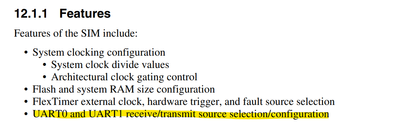

在MKV31F512VLH12的SIM_SOPT5中,只有UART0/UART1的TXSRC/RXSRC,而UART2的SOPT没有找到,请问如何处理UART2的SOPT。

Hello @shuangda228 ,
Thanks for your post. Please refer to the reference manual of the MKV31F512VLH12.
The TXSRC/RXSRC of UART0/UART1 is used to control the receive/transmit source selection/configuration.
For UART2, this kind of function is not supported, so there is no SOPT for UART2. This is normal.
Hope it can help you.
BRs,
Celeste
