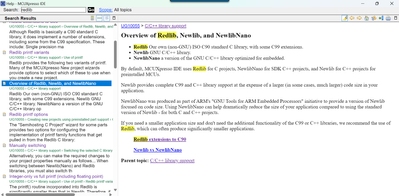

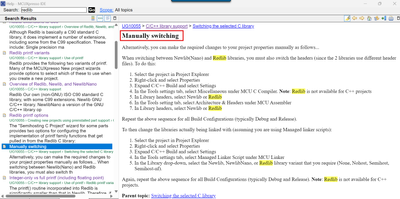

Besides, I suggest that you try increasing the size of the heap/task stack.
Redlib is not open-source. If necessary, you can consider switching to use Newlib/NewLibNano. The specific switching method can be seen in the figure below.

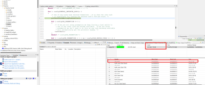

What I noticed afterward were anomalies in the Heap Usage (FreeRTOS) debugger tab.  The MCUXpresso_IDE_FreeRTOS_Debug_Guide.pdf manual was unclear: Under "Details", every other line shows "Allocated".  I think this allocated size is some sort of linked-list that tracks all of the blocks used by the allocation that's mentioned on the NEXT line under "Details".  If this is correct, is it normal for this Allocated size to be 40 kB when the following Task Stack line is only using 25 kB?

Thank you for the reply.  I can reliably cause a crash within 5 minutes; as I mentioned, I only have to remove then replace the Ethernet cable.  Before I submit a support ticket, maybe it's best that I understand exactly what the Heap Usage (FreeRTOS) debugger tab is showing.  Please tell me whether any of the following statements are incorrect.
There is the FreeRTOS heap (mine is using heap type 4), its size is defined in FreeRTOSConfig.h.  Calls to xTaskCreate() allocate their initial (function parameter) memory from this heap.  Then, a task's C code can later call pvPortMalloc() to request more memory blocks, which also come from this heap.
The memory parameter in a xTaskCreate() call is recorded as "(Task Stack)" in the Heap Usage (FreeRTOS) debugger tab.
The Task Control Block memory for each task is recorded as "(Task TCB)" in the Heap Usage (FreeRTOS) debugger tab.
Does an "Allocated" line show the extra allocations for the line description that's ABOVE it or BELOW it?

I don't think the "Allocated" lines show byte alignment memory use because I have seen them grow significantly in size.  For example, see the attached screenshot.
Do these Allocated lines include successful calls to pvPortMalloc(); can you confirm with someone that this is what that debugger tab is supposed to show?  Thank you.

Sorry, I was indeed wrong before. "Allocated" does not represent the memory used for byte alignment.
The Heap Usage lists the FreeRTOS heap status with all the memory blocks allocated in it. The "allocated" lines represent the total amount of memory allocated through the heap. It reflects the memory usage of the FreeRTOS heap area, including the memory allocated by pvPortMalloc. The memory occupied by both tasks and other resources will be displayed here. It's just that the memory occupied by tasks is marked separately.
