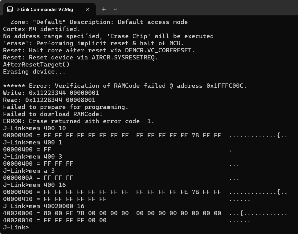

I'm having flash erasing problem when using j-link(connect target successfully),  it happens eveytime. Please help to identify the issue thanks.
I have tried set the SWD speed to 200kHz but no difference.

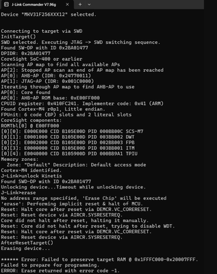

The SWD pins are configured right. I'm trying to unlock a secured MCU from our customer but failed, below is the response. Command : connect -> unlock kinetis -> erase
Do you have another way to unlock MCU? Preferably using PE micro Cyclone.

To unlock the device if Flash is secured follow the following steps:
Using MCUXpresso IDE to Unlock the Device
1. Verify Connections and Settings:
  • Ensure that the J-Link, Multilink LC, and other debuggers are properly connected to the MK64FN1M0VLL12 MCU.
  • In MCUXpresso IDE, select the appropriate debugger (e.g., Segger J-Link) and confirm the target device settings.
2. Check Debugger Firmware:
  • Update the firmware of the J-Link and Multilink LC to the latest version. Older firmware versions may lack support for certain functionalities.
3. Using J-Link Commander to Unlock:
  • Open the J-Link Commander and execute the following commands:
J-Link> unlock kinetis​
  • If you encounter errors, please ensure that no other applications are using the debug interface and that the connections are stable.
1. Check Connections and Commands:
  • Verify that the connections are secure and enter the following commands in J-Link Commander, for example:
J-Link> connect Please specify device / core. <Default>: MK64FN1M0xxx12 Type '?' for selection dialog Device>
  • After specifying the device, proceed with the command:
2. Refer to J-Link Documentation:
  • Consult the official J-Link documentation or contact Segger technical support for detailed instructions on unlocking Kinetis MCUs.
Additional Suggestions
1. Check MCU Status:
  • Verify the security status of the MCU. If the status is "Secure" and factory access is denied, specific unlocking procedures may be required.
  • Ensure that mass erase is enabled and backdoor key access is disabled.
