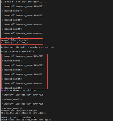

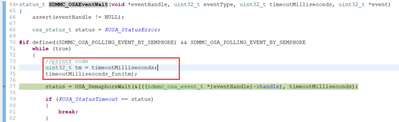

I experimented with the MK66FN2M0xxx18 development board and the "frdmk66f_sdcard_fatfs" program in the SDK. It didn't seem to hang in SDMMC_OSAEventWait. I tried to print out the values ​​of timeoutMilliseconds and semCount and found that the value of semCount was changing, and the return value of the OSA_SemaphoreWait() function was KOSA_StatusSuccess.
The location of adding the test output function is as shown below.
I can see the output results as shown in this figure, which outputs the values ​​of timeoutMilliseconds and semCount during the program execution, and creates files in the SD card.
I have attached the program, I hope this can help you.
