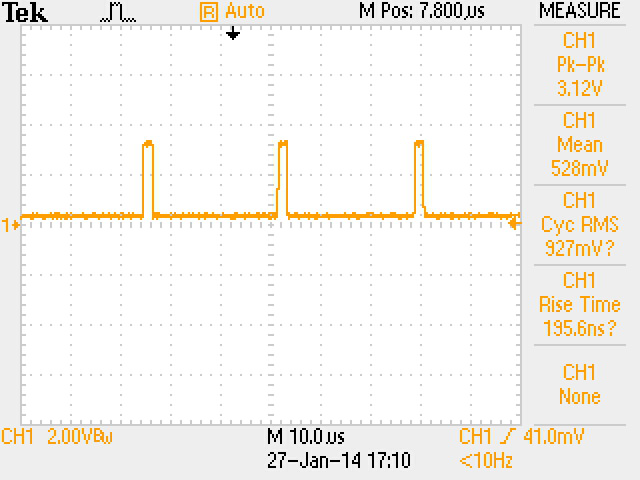

I am trying to program my custom board with a chip MK64FN1M0xxx12
To program the board I am using the Segger J-link M cortex. When I connect Segger to my board there is a red led (I think meaning of this Red led is the controller is in reset mode).
I followed all the solutions given in the community like
10K pullup at NMI pin
10K at SWDIO/TMS
I followed the
How To Sucessfully Program a Custom made Kinetis Microcontroller Board.
According the above link , when I put a probe on reset pin same waveform is getting like thispastedImage_10.png
To mass erase my chip I tried GUI FLASH TOOL , but the error is generated

I tried to program both by using SWD and JTAG.
Please help me to solve this essue.

Dear Kapil,
I see that you're using the command line and a script to flash the MCU. Could you try using the command 'unlock kinetis' before programming the MCU?

kapil_p
Hello Alexis
   Thank you for yours reply.
            I successfully downloaded the code , I unlocked and erased the chip using J-link commander.
Thank you
