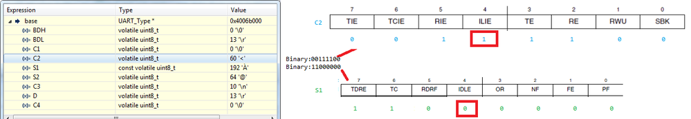

bgraham
I added the line UART_EnableInterrupts(DEMO_UART, kUART_IdleLineInterruptEnable); before the call to UART_TransferStartRingBuffer().
After UART_UserCallback() kStatus_UART_RxHardwareOverrun, I checked the registers.
UART1 C2.ILIE is 1
UART1 S1.IDLE is 0
See registers below.
See code below.
Since C2.ILIE is set, why would UART_UserCallback() never got called with kStatus_UART_RxIdle?
Bruce
