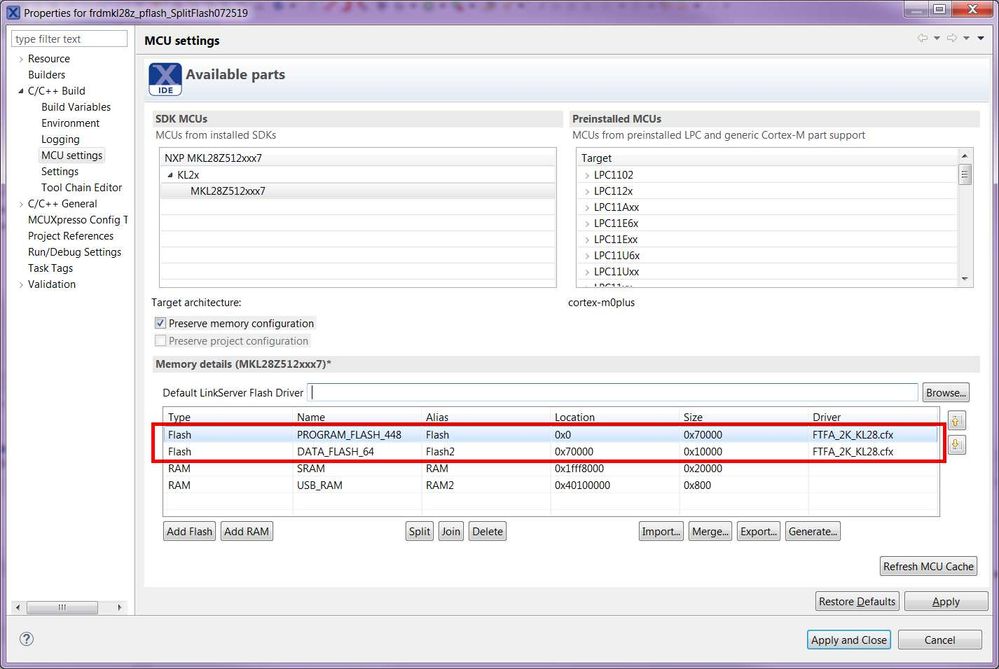

Great info & related post links.   I'm devouring all right now.   If you see the "Memory details" window screenshot on my recent response this morning posted above, it shows the default memory map of an SDK flash project, how it is in MCUXpresso very similar to your article how you did it in PE.   I don't have that "InfFLASH Component" as used in PE so I SKIPPED that section on your old article.   Do you think I'll do well in MCUXpresso without having something similar?
This snapshot below is the new memory configuration AFTER I split the flash & made memory range adjustments..   I only took the top 64KB flash memory, subtracted 64KB from 512KB, leaves 448KB for vector table & code.   This is just for practice in this project.   I'm not sure if I had to specify the same "driver" for both flash areas as shown on the rightmost column but I did anyway.    Build did not complain but I have not debugged because I'm still about to change the code.   I'm not flash programming as this project is about.   I'm writing data into the flash memory 64KB I allocated.   My plan in step-by-step... following your post.
Now, I'm about to do the header file & source programming for setter & getter functions similar to what you did.
I'm not sure if changing the "Names" column would affect anything in linker & I wonder whether or not I use these names in the definitions will have any bearing since there I'll be HARDCODING direct memory address definitions like those in your header file example.
Before I do that I have some detail I'd like to ask >  Question: Referring back to your Memory Configuration of internal flash inside Processor Expert (PE),  did you intentionally "bypass" the details about the memory range between MemoryArea2 and the added MemoryArea4 which is MemoryArea3 because Area3 did not have enough space to take out from? basically 1FC00-1F7F0 = 410h = 1040d (an odd number)?   Just curious...

I was thinking along those lines as you are advising but I needed an expert like you confirm to me.   Linking is good way because the binary result will already make all memory map aligned, wherever you port the FW the process, any flash programmer will put things in the right place.   Am I correct?
My concern with "split" is it will take my 512KB flash & split it in half so I will only be left with 256KB for vector & code.
I don't like minimizing my code when I may only need, say, 32KB of data, not 256KB.
I like how PE lets you manually specify address range & size at will but as MCUXpresso is more newer & supposedly more powerful, I'll see if that is also possible to do.    Do you know?
I'm thinking for experiment after I "Split" Flash section,  I can then modify columns "Location" & "Size".    I'm going to try such on a dummy project & trying out the rest of your examples.   I'm studying all the links that are embedded in your linker blog post, links within links... so I can know better how these memory mapping & linking works.

For any project in MCUXpresso, under Properties, there's the  C/C++Build -> MCU settings -> Default LinkServer Flash Driver Memory Map.    Based on your example,  I wonder if I need to MODIFY ("Split' button) the Flash Area so the flash program space will separate from the planned data flash space?
Also under Debug Configurations (I use PEmicro Debugger) -> Debugger tab - Advance Options button,  on the pop-up window, there is option to "preserve" non-volatile memory by range from & to boxes.
The Flash memory range of MKL28Z is 00000000-0007fffh.  Do I just define a memory block within that range that I know should be protected from flash erasure & code programming by using that "advance" options under debug configurations?
Outside of debugging, how will this allocated data memory space pan out when binary code flashing with standalone programmers?
Is the data range now based on what's defined in my firmware in a header .h file, by HARDCODING those addresses to read/write from & creating special function calls in a source .c file like you have done in your example?

The article in Configuration Data: Using the Internal FLASH instead of an external EEPROM | MCU on Eclipse  describes the principle, but is using Processor Expert. Technically you can use Processor Expert in MCUXpresso IDE, but PEx is a legacy technology by now.
To your questions:
- yes, you should split your FLASH memory so you have a dedicated area for your flash programming, otherwise the linker might place code/data there
- Best if you use a memory block at the end of the FLASH area. Make sure it is aligned to the block size of your flash (e.g. 8K).
- Hardcoding the address is the most simple way to use it. The more elegant (but more complex) way is to define linker symbols (see Accessing GNU Linker Script Symbols from C/C++ | MCU on Eclipse )
