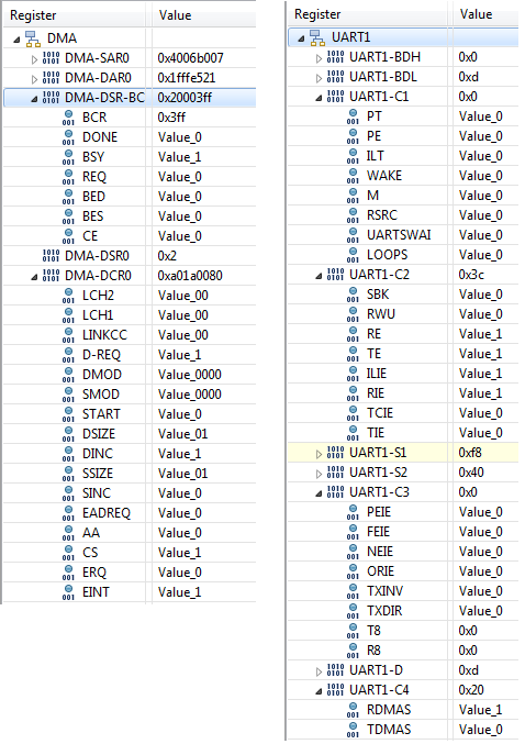

I started with the driver example UART dma_transfer project.
The project has the DMA RX setup to receive fixed length transfers.
I am working with a modem, so I can't predict the transfer length of the data from the modem.
I need a why to end the DMA RX transfer when the UART line is idle.
Is it possible to end the DMA transfer when the UART Controller generates an IDLE interrupt?

Mark,
thanks for pointing out that setting DMA0.DCR.EINT to 1 will cause problems.
I also used the DMA DAR to determine how much data is in the DMA buffer.
I found that using a single DMA buffer was not working.
Coping the data from the single DMA buffer would take to long, and before resuming the DMA, the UART D would Overflow.
I solved the Overflow problem by quickly switching between 2 buffers, resuming DMA, and then coping data from the old buffer.
I code has been running with for hours without any errors, so I feel confident that this is working. See below.
Thanks for putting up with my frustration.
Bruce

I gave up on the free running DMA.
The UART interrupts are stolen by the DMA controller.
Since the timer has to clear an error before any more data can be received, all the characters that arrive between timer ticks are lost.
Since the errors were not being cleared before the next character came in, the OR flag would be set.
I ended up creating my own UART1_IRQHandler().
UART1_IRQHandler() does 3 things:
* clears errors
* puts received chars into a queue
* if RX IDLE occurs, it sets aFreeRTOS event
That worked. See below.

Thanks for everyone's input.
I have spent a week trying to get the KL26 UART and DMA to do what I want. I agree with Mark about the overrun problems.
The problem:
I have a modem that spits out status strings are unpredictable times.
The modem only works at 115200.
My app needs to ack as soon as the UART RX goes IDLE.
My app also needs to use minimal power, so the MCU needs to sleep until the UART IDLE event occurs.
My app uses FreeRTOS, so the solution must work with it.
The cause:
The MCU is in sleep mode, it takes time coming out of sleep before it can handle the UART ISR.
The UART hardware overrun occurs before the MCU is awake and completes the UART ISR.
NXP solutions that don't work:
The NXP has provided examples for the UART and DMA that all the have this problem: by the time the sleeping MCU has waken (clocks clocking, etc), the next char has been received by the UART, and it has overrun.
The FreeRTOS UART examples are worse, the receive function waits forever for a fixed length string that it might never receive.
Conclusions:
With a UART running at 115200 and a sleeping MCU, the use of UART or DMA interrupts will not work. Period.
A possible solution:

My current version is mostly working as I described above, but I used a FreeRTOS timer instead of a hardware timer, so I used the non ISR forms of the FreeRTOS APIs.
I have the UART, DMA buffer switching and FreeRTOS timer working.
The code gets the first modem string from the first DMA buffer.
But, after the 2nd DMA buffer is setup, the DMA fails to trainsfer the 2nd modem string.
I can see that the first char of the 2nd string is getting into the UART's D register, so it seems that the DMA controller has failed to start the 2nd DMA transfer.
My timer code is starting the next DMA using DMA_SetTransferConfig() to setup the buffer. It uses DMA_TriggerChannelStart() to start the next DMA transfer by setting the DMA DCR START bit.
See below.
DMA_ResetChannel(baseDMA, channel);
// Switch DMA buffers
switch(s_iCurrentBuffer)
case 0:
memset(s_szBuffer1_DMA, 0, s_iSizeOfBuffers);
s_dma_transfer_config.destAddr = (uint32_t)s_szBuffer1_DMA;
s_iCurrentBuffer = 1;
break;
case 1:
memset(s_szBuffer0_DMA, 0, s_iSizeOfBuffers);
s_dma_transfer_config.destAddr = (uint32_t)s_szBuffer0_DMA;
s_iCurrentBuffer = 0;
break;
DMA_SetTransferConfig(baseDMA, channel, &s_dma_transfer_config); // Use the saved config
DMA_TriggerChannelStart(baseDMA, channel);
UART_EnableInterrupts(baseUART, kUART_RxDataRegFullInterruptEnable);
The UART appears to be getting the first char from the modem's 2nd second string.
See DMA0 and UART1 registers below.
DMA-DSR-BCR0 BSY is 1
DMA-DCS0 EINT is 1
DMA-DCS0 START was set
I think the 2nd DMA transfer is not getting started.
What might explain why my 2nd DMA transfer fails to start?
Bruce
8,506 Views
bgraham
I found the problem.
Each DMA transfer is clearing DMA-DCR0 ERQ.
To set ERQ, I added DMA_StartTransfer(s_handleDMA->rxDmaHandle) after DMA_TriggerChannelStart(baseDMA, channel).
Setting ERQ looks like it is working!
Thanks for every one's ideas.
I attached the working project.
Bruce
