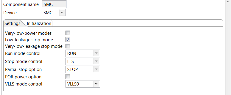

Like the tittle says, I'm using MKL17Z256VFM4 and want to make it enter LLS mode. I want the MCU to wake up from LLS mode through the LPTMR. Also, I am using SDK 1.3.0 if that changes anything.
Here is what I have so far.
Using Init_SMC in processor expert, I enable Low-leakage stop mode. Processor expert looks like this.
SMC seems to be initialized correctly, since I am reading this from the SMC registers.

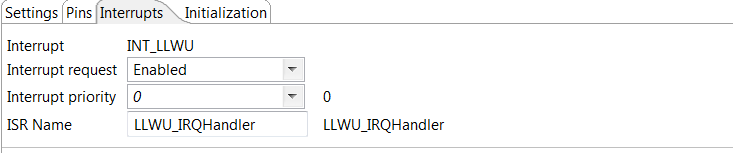

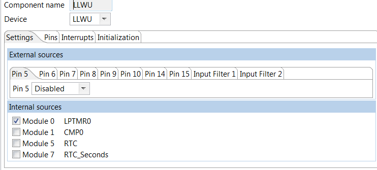

I've also enabled the LPTMR and tested the interrupts coming from NVIC and it seems to be working fine. Since NVIC is disabled in LLS , I added the LLWU component with processor expert to enable LPTMR0 and link an ISR to LLWU. This means I should wake up from the LSS through an LLWU triggered by the LPTMR0. Here's what the initialization looks like.
The LLWU_ME register reads 0x1, which means module 0, corresponding to LPTMR0, is enabled. So the LLWU should be set properly.

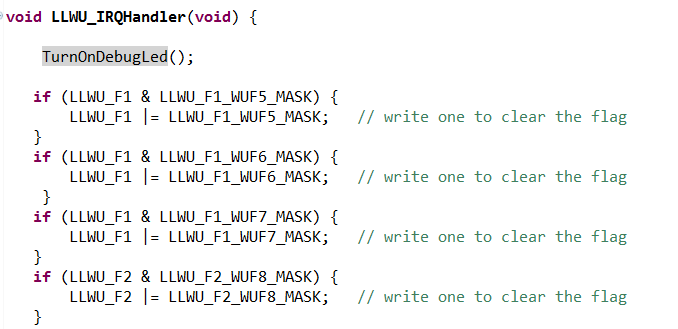

I created a file named LLWU.c to go along the generated LLWU.h and created a function in there called LLWU_IRQHandler that basically does nothing for now but that will eventually be used when waking up from LLS.

For example, at what point is LLWU_IRQHandler() entered? The way I see it currently, and it may be completely wrong, is that I enable the LPTMR IRQ in the LLWU settings, I then put the device in LLS. At that point, when the LPTMR IRQ happens, the device will wake up and run the LLWU_IRQHandler code and return to wherever it was after entering LLS.
From reading through one of the links you shared, it seems that the device will automatically go back to RUN mode after a LLWU event so I don't need to worry about that, but if I want anything else to be done specifically after a wake up ( For example turn on a debug Led to confirm the device woke up)  I should do it in the LLWU_IRQHandler.

When setting up the LLWU, I enable the LPTMR module as a wake up source. Do I have to also enable the LPTMR interrupt itself or do I only need to enable the LLWU interrupt?
